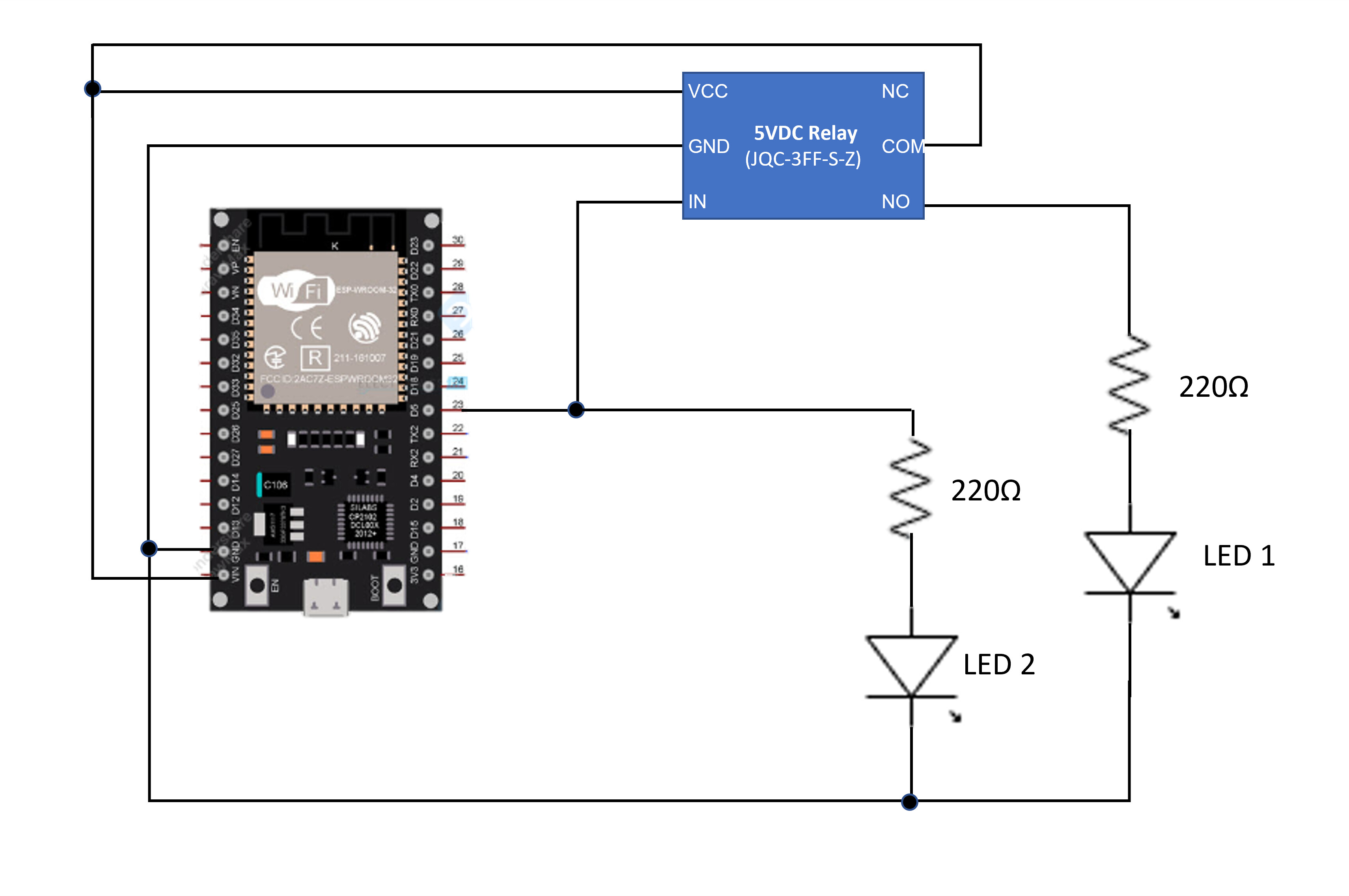

Objective: Getting LED 1 to switch on & off for 5s each using a relay
Problem:
My relay does not trigger, with LED 1 being continuously on.
Whereas LED 2 switches on & off for 5s each, despite being on the same circuit.
Equipment: ESP32 dev board x1; 220 Ohm resistors x2; LED x2; 5VDC Relay x1
const int relay = 5;
  pinMode(relay, OUTPUT);
  digitalWrite(relay, LOW);
  Serial.println("Current Flowing");
  delay(5000);
  digitalWrite(relay, HIGH);
  Serial.println("Current not Flowing");
  delay(5000);

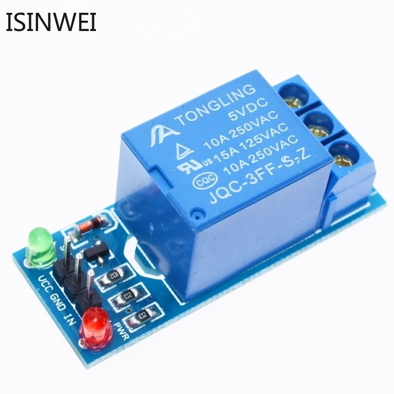

Perhaps a picture of the relay module?

OK, so that was somewhat confusing. :grin:
What you meant was that the relay is always on or in fact "triggered" and illuminating your "LED 1".
This is a "low level trigger" relay module and when powered from 5 V (as it must be), connecting its "IN" terminal directly to an ESP I/O means that the "IN" terminal is always LOW since 3.3 V is lower than 5 V. :astonished:
Just connect LED 2 - with no resistor - between the ESP I/O pin and the relay "IN" - with the LED anode to the relay module. :+1:

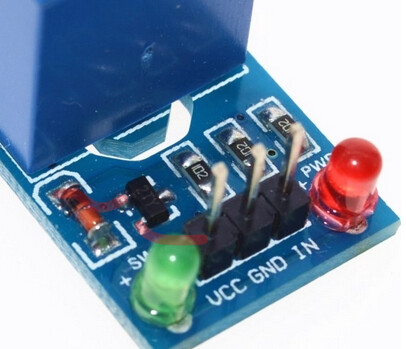

I think one of the board's LEDs is for VCC present and the other is likely an Input indicator (no external LED required).
It also looks like it has a transistor there (common emitter? IDK), not an opto-device.

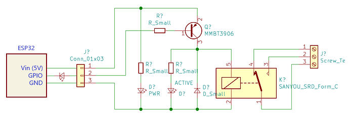

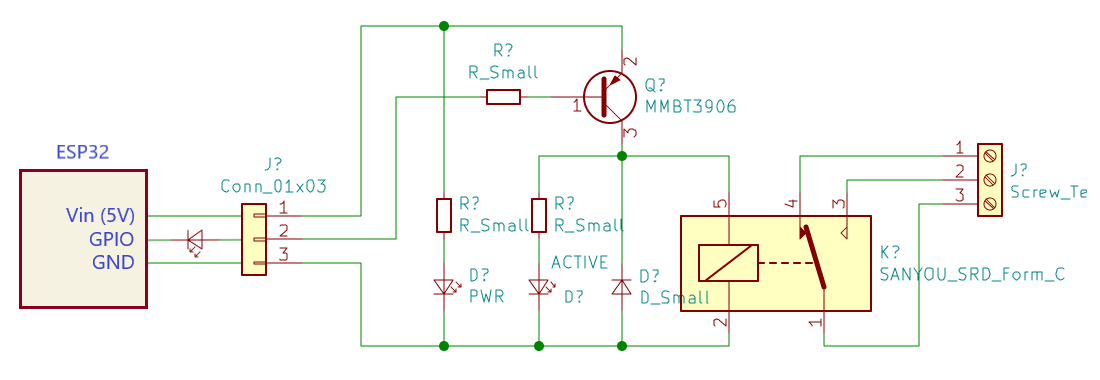

The transistor is PNP switching the high side of the relay coil. Below I've highlighted the path of VCC to the PNP to the relay coil +''ve terminal on the PCB:
The base transistor is 1K.
Possible solution:
I suggest trying this with an LED to drop the relay "IN" voltage ... LED anode to IN, LED cathode to ESP32 output pin. The LED will illuminate and the relay should energize when the ESP32 output pin goes LOW. Use Vin (5V) from ESP32 connected to relay module VCC
