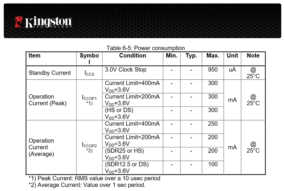

How do I interface two SD cards in the same project?
plus an LED would only be 100 milliamps.
In spi mode it is less:
And from the forum:
Some very interesting (and damming) evidence for this voltage regulator if I want to use a Kingston card:
And from SanDisk:
What does everyone think? Should I risk using the NCP561SN33T1G?
