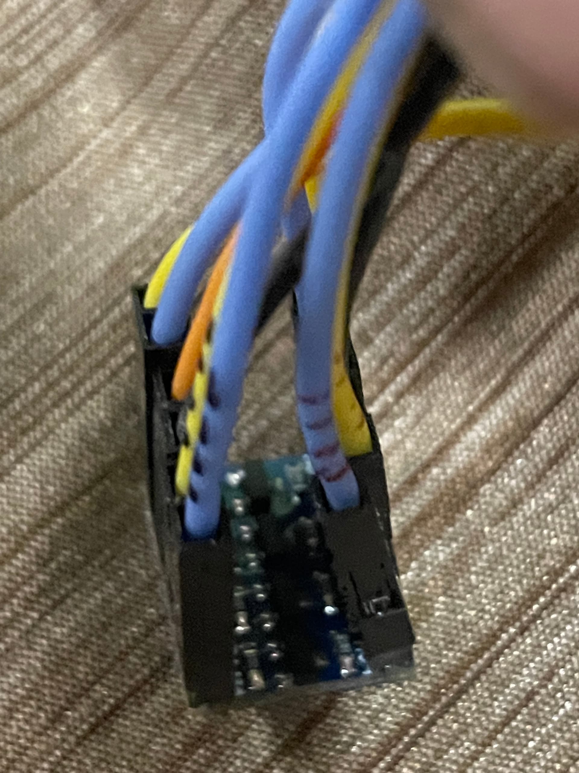

I now have a logic shifter in place and voltages are back to 3.3V on VCC, CS, MISO and MOSI. Unfortunately, Cardinfo still gives "initialization failed".
I've checked continuity and correct connections on the wiring. Card is inserted and fully functional. Chipselect changed in Cardinfo to the correct pin (53) for Mega. Did I damage the card reader when it was powered without the logic shifters? Is there anything else I can check to see if the module is working correctly?

Even with your full wiring description, posting a wiring diagram will be more descriptive at a glance. Also, include the minimal sketch you are using.
Barring any wiring fault, I'd suspect it's the microSD doesn't take kindly to 5V.
The card works fine in my laptop. No errors on installing it, I can save, open and delete files on it. "Properties" shows fat32. I don't have another card to test right now. I'll get one tomorrow.
Comment 11 in this post SD card using ICSP pins - #11 by CrossRoads talks about mismatch between the current the Arduino can supply vs that required by the SD card. Is this relevant? If I'm interpreting it correctly, the problem is with the signal voltages not the supply voltage, so I don't think it applies to my case(?)
Sketch is below. It's the example one from the IDE. I've trimmed all the stuff after initialization as that's where I'm getting the failure, but the full version (with pin 10 -> pin53) gives the same results.
Wiring photos and sketch below. Note 5V is red, 3.3V is orange, ground is black:

I think 3v3 from the HV side should NOT be connected to 3v3 on the LV side. Only ground should be shared. Oops. This is for serial.
I now see with SPI, HV side also supplies 3v3 to LV side.
Could you swap SDO with SDI on the Mega side (or MOSI and MISO on the uSD) ?
I don't understand either of these comments. 3V3 is not shared; HV is connected to 5V, LV connected to 3.3V. Or am I missing something?
Swapped them, no change in results.
