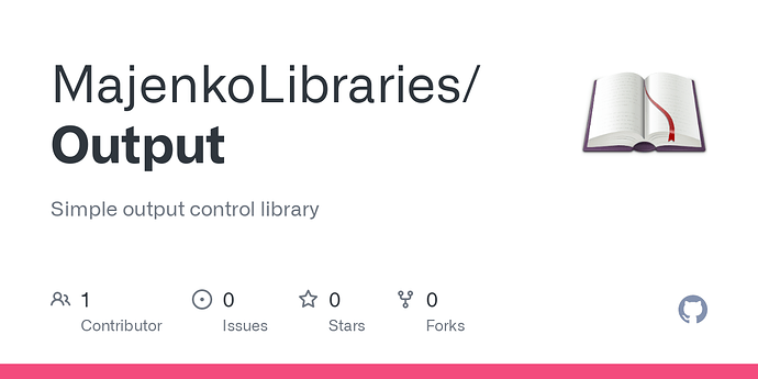

I have a nice little class that abstracts the pin output and provides some helper functions for simple pin manipulation. It also remembers the state you set the pin to for you, and allows you to query it.
