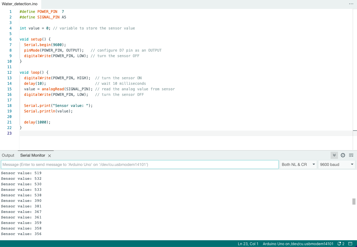

Hello, I am extremely new to this, I am working on a pipe leak detector for class, and with some tutorials, I got a water sensor and an active buzzer working. However, I only managed to get them to work separately and I do not know how to get the water sensor to trigger the active buzzer. I've attached the buzzer and water sensor code, please help.

Oh, you're almost there. I assume you used this tutorial
Using your sensor sketch, follow the "Water Level Sensor Calibration" towards the bottom. This will establish your threshold.
Then use the "How To Detect Water Leakage" section and sketch. Rather than an LED, you are using an active buzzer.
Good Luck
