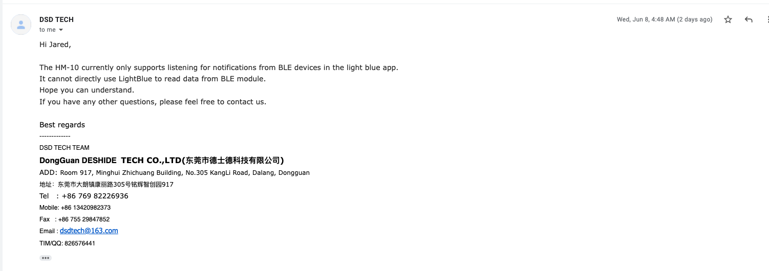

I suggest that you work with dsd technical support. You may be able to use AT commands to change the characteristic from read/notify to read only.
Thanks for the ideas here. no difference from the DSD tech phone app.
I Am doing this. it's decent but i feel like i'm getting the run around for 2 weeks now. different ways of them not saying no without giving me a yes as to whether or not it's available.
Just to close the loop here. Even though it's sold as if this is possible, the device indicates it's writeable/readable, the staff at DSD have verified what I am trying to accomplish won't be possible.
