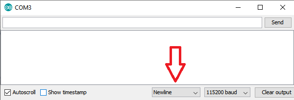

As a test try printing the length of the String that you enter. Is it what you expect ?
What is the line ending set to in the Serial monitor ?
Thanks for replying, I did check, and your doubt is correct, the length of S2 containing Dhaval is 7 whereas the already defined s1 string Dhaval is 6. What it could mean? Does the serial monitor assign an extra random character to the string s2?
No, it adds the line ending characters that you tell it to, hence my question about how you have that set
How is your serial monitor configured here?

Same, I looked up strings in arduino and c++, how to compare them, how to maybe utilise the equalTo method, or as I had done look to use '==' operator as well. So far, as I test this, the string length shows to be 7 when the user inputs Dhaval as the string in the Serial monitor.
Line ending is newline in the serial monitor. Although I have looked up and that doesn't look to create much of a difference in the output.
'Newline'
So, the problem was me. As I said, I am fairly new to Arduino, and upon trying this, changing the no new line it actually resolved it. I was so happy to know that the legacy code I wrote wasn't wrong at all, it was my lack of knowledge about Arduino.
Thanks a lot. The code works now and I have it fully updated with the Serial Monitor turned "No new line" and the code actually does what it was supposed to. I really appreciate everyone's help and I cannot thank you all enough for helping me understand and find solution to this.
