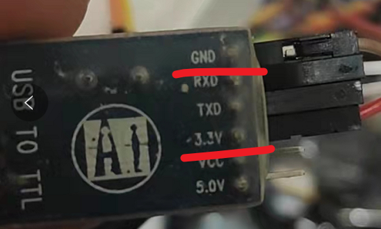

  2. The Sensor connects the TTL to USB power supply pin, but the output is still abnormal.(I used PWM pin by esp32 or xiao MCU to output analog 3.3V, results same to abnormal output)
    enter image description here
  3. If the sensor signal output is connected to MCU, the high value of 4000 is output(The original value). Seems to be the power problem, someone tell me how to minimize the power ripple effect and make the 3.3V stable output provided by the battery?

Don't use the CH340 3.3V output pin to power sensors.
It's probably only rated for around 25mA. I think its only intended to power a few external logic ICs if required in an external circuit. This is similar to some FTDI adapters I've used where its 3.3V is generated in the serial IC and is rated for arounf 40mA.
Solution: Use a proper 3.3V power supply.
EDIT: OK, it looks like your sensor draws only 20mA, however I see no capacitor across the sensor's VCC and GND pins or on the breadboard.
