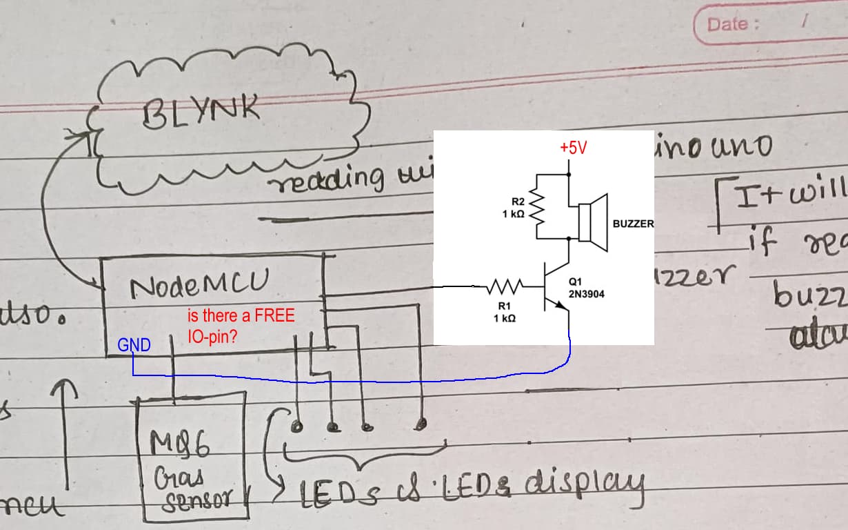

I still have the question if you have a not yet connected IO-pin on the nodeMCU
And YES of course there is a free IO-pin. exactly that one that you are using for the serial connection.
So if the buzzer is really the only thing that the arduino shall make buzzing and nothing else you can use exactly this io-pin for the buzzer
It might be that a transistor is needed to drive the buzzer if the buzzer draws more than 2 mA. But you don't need the arduino
