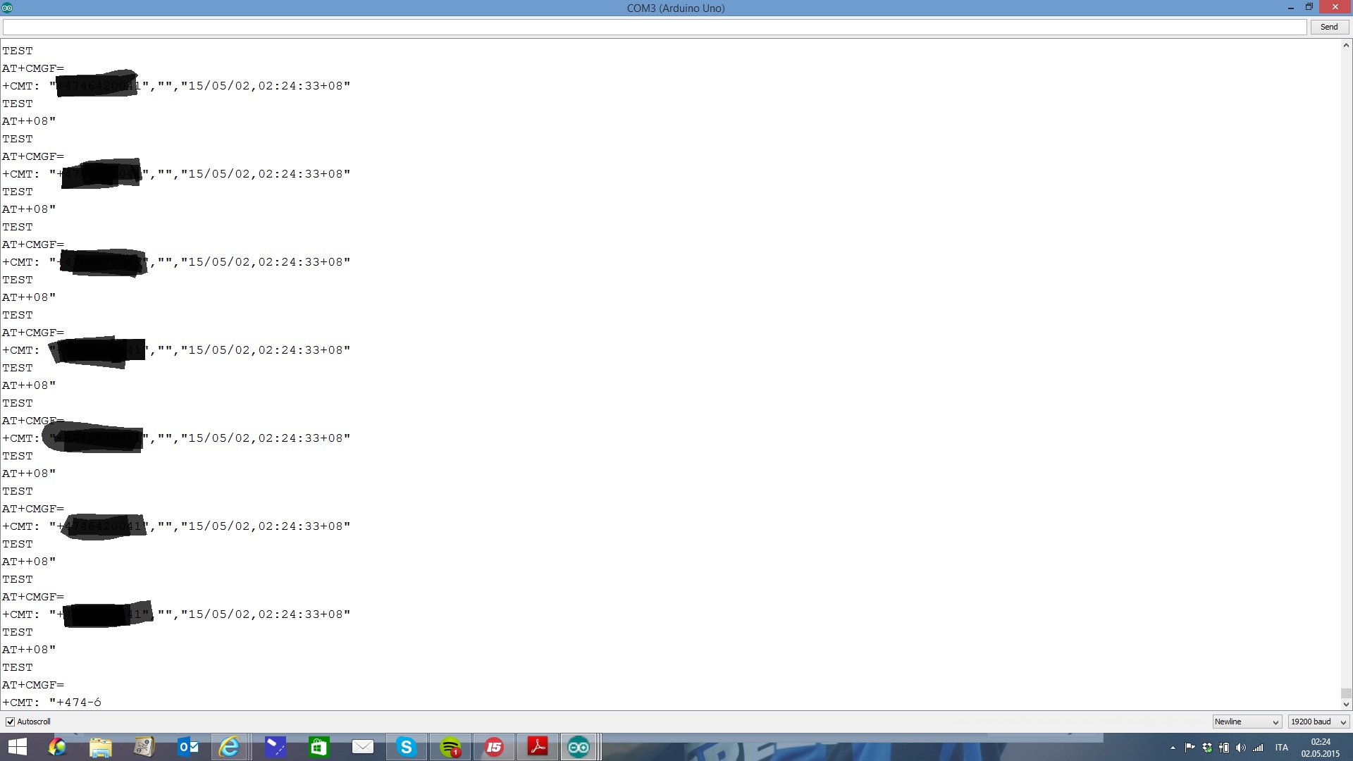

Got some progress :slight_smile: ...
Now the message that i send its recognize from the arduino and publish on the Serial (print out_byte array).
Problem its not recognize the If condiction. So cannot start the function SendSMS();

Tried. Same staff.. display the Message in Serial but does not go forward to compare the IF condiction. :confused:

You still need to show the output you are getting, and all of your code. Is the buffer too small to hold all the message at once?
I have resized the array to 100 carachters. The thing "interesting" its when i am sending the SMS from my mobile , the Serial repeat some AT commands from setup(). If i am not mistaken Setup function should run only once as loop :o . Take a look on Pictures Attached.

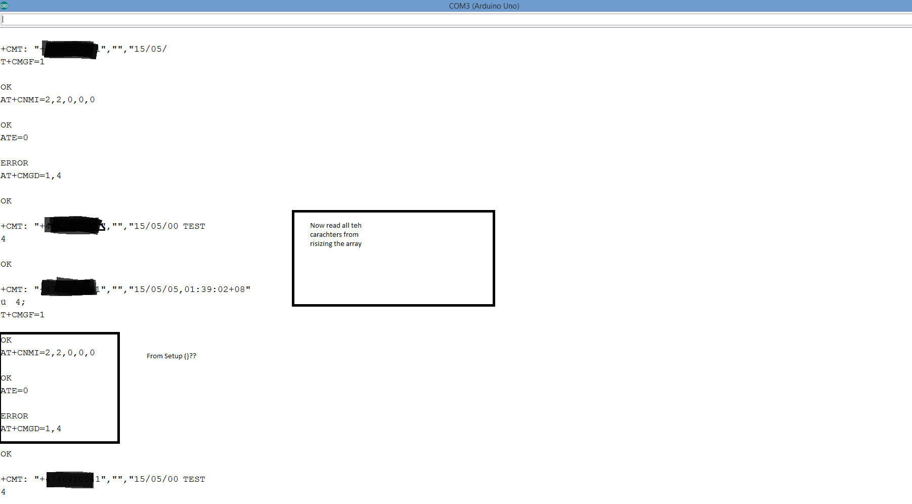

At the end of setup() print out cleanbuffer just to make sure that it's doing it's job? Then do a while(1){} to put it into an infinite loop so you don't continue into loop().
To save memory I would have used the same character array to clear the serial buffer and then to hold any incoming messages.
I follow it until the point of have a single array. I tried to use a single one but do not work; With two its working :grin: BUT until the buffer/s are full than no response. How can I empty the memory of the array? I tried different Methods but anyone seems working :-[

Okay. I used "pen and paper method" :slight_smile: and thanks to it I figure out in an other way.
In the loop will read all the messages until 150 characters, than IF the message is according to the specific condition, so = test, will go to the sendSMS() and than restart the software (instead of clean the array, but i have done also that just to be sure). Very effective. XD
What do you think? btw thank you so much for the help dannable!.. I have learn a lot thanks to you!
/*If sms send = TEST than you get a SMS reply to your own phone*/
#include <SoftwareSerial.h>
SoftwareSerial MySerial(7, 8);
char incomingbyte[150];   // array to compare incoming SMS
int index=0; // array to compare incoming SMS - index
int count=5; // counting to 5 connecting network (Setup setting)
int i=0;  // Setup setting
int y=0; // condition to read incoming values
/*The setup will start in 19200 baud both Serial and My Serial, later count until 5 to connect to network and start the AT commands parameters, so
SMS messages and parameters*/
void setup(){
  Serial.begin(19200);
  MySerial.begin(19200);
  for(i=0;i<count;i++){
  Serial.print(".");
  Serial.println("done");
  delay(50);    // 10sec/10000ms delay to connect to network
  MySerial.println("AT+CMGF=1\r");                       // SMS mode totext
  delay(100);
  MySerial.println("AT+CNMI=2,2,0,0,0\r");               //blurt out contents of new SMS upon receipt to the GSM shield's serial out
  delay(100);
  MySerial.println("ATE=0");                             //echo off
  delay(150);
  MySerial.println("AT+CMGD=1,4");                       // delete every message from SIM
  /* in loop will read all the incoming messages unti 150 carachters, then will discard all the messages not according to "Test" by resetting the carachter array and
  restarting the software */
  void loop(){
    if(MySerial.available()){  // read all the incoming messages from your mobile to Shield
    do{
    incomingbyte[index++]=MySerial.read();
    Serial.println(incomingbyte);
    }while(y==0);
    while(strstr(incomingbyte,"Test")){ // if message is according to Test, than start the SendSMS function
    sendSMS();
    delay(100);
    if(index>=140){ // condiction: if messame more than 140 carachters then discard it, clean array and restart the software
    for(index=0;index<150;index++){
    incomingbyte[index]='\0';
    Serial.println("cleaning done, restarting");
    delay(300);
     software_Reset();
