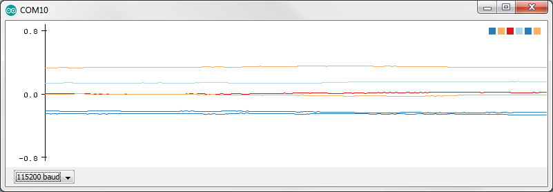

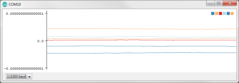

There are a lot of articles about this matter, but since we have the Serial plotter I would like to add this one.
Programming a digital dice you would code something like this: byte r = random(1,7);
And on the long run you would expect the numbers 1 to 6 distributed faily equally.
Use this little sketch:
  Serial.println(__FILE__);
float est = 100.0 / 6;
long count = 0;
long freq[7];
  count++;
  freq[r]++;
  for (byte i = 1; i < 7; i++) {
    Serial.print(100.0 * freq[i] / count - est, 4);
    Serial.print("\t");
  Serial.println();
and activate the Serial Plotter (IDE version 1.6.7).

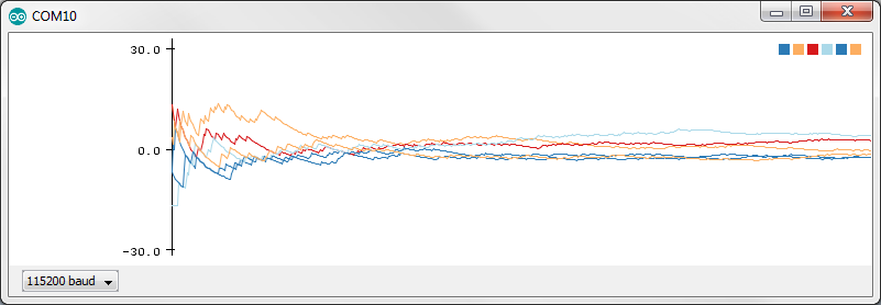

If you expect the values to approach the zero line after a while you will be disappointed.
See attached screenshots.
Even after thousands of random calls the lines run very differently from each other.
(Donald Knuth taught us how to do it properly.)
For most purposes the random function will do but it surely could be improved.

So what are your findings?
After throwing the dice 6 million times you'd expect that each side showed up one million times exactly?
But actually the random function generates a discrepancy of let's say 0.01% or something like that?
How much is that?
1% of 1 million is 10000.
0.01% of 1^million is 100.
So throwing the dice 6 million times shows each number in the range of 999900 to 1000100 instead of exactly 1000000 times.
Or what do you want to say?

Actually, the problem might not be in the PRNG but in the bracketing to 1-6.
In this case changing the seed does not matter, that will just start you in a different place in the sequence.
Thank you for all your postings.
Of course: software random generators are all pseudo random generators.
And changing the seed does not matter, even if you take it from A0.
In theory, according to the Law of large numbers, the observed relative frequencies should converge.
Well, gpsmikey's comment was somewhat off-topic, but I agree completely.
And KeithRB eventually got the point:
yes, I could track it down.
The gcc uses the linear congruential generator (LCG) published by Park and Miller, Communications of the ACM, vol. 31 in 1988 and since then proven correct may times.
(avr-libc/rand.c at master · vancegroup-mirrors/avr-libc · GitHub)
The random function returns a 31-bit value, the period is the maximum possible period (sign-bit always cleared).
So, when you call random(a,b) some multiply and divide operations have to be performed.
And that is where the loss of precision happens.
I managed to find a work-around by successively comparing the 31-bit random values to RAND_MAX/2, RAND_MAX/3, RAND_MAX/4, RAND_MAX/5, RAND_MAX/6 getting much better results. But the code looks so ugly that I do not dare to publish it.

What you have there is known as a "Gee Whiz" graph (the axis is magnified to suggest a discrepancy much larger than is really significant).
