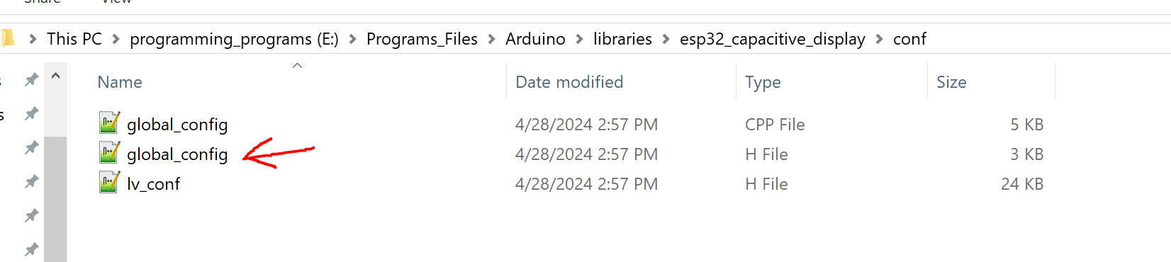

How to address this header file ?
I copied source code for the esp32_3248s035C display. I removed the non-arduino files and kept the C/C++ files.
I want to address the header files in my custom folder:
I tried this addressing but it didn't work:
Is there a solution for this problem or I have to copy the source code into my arduino code ?

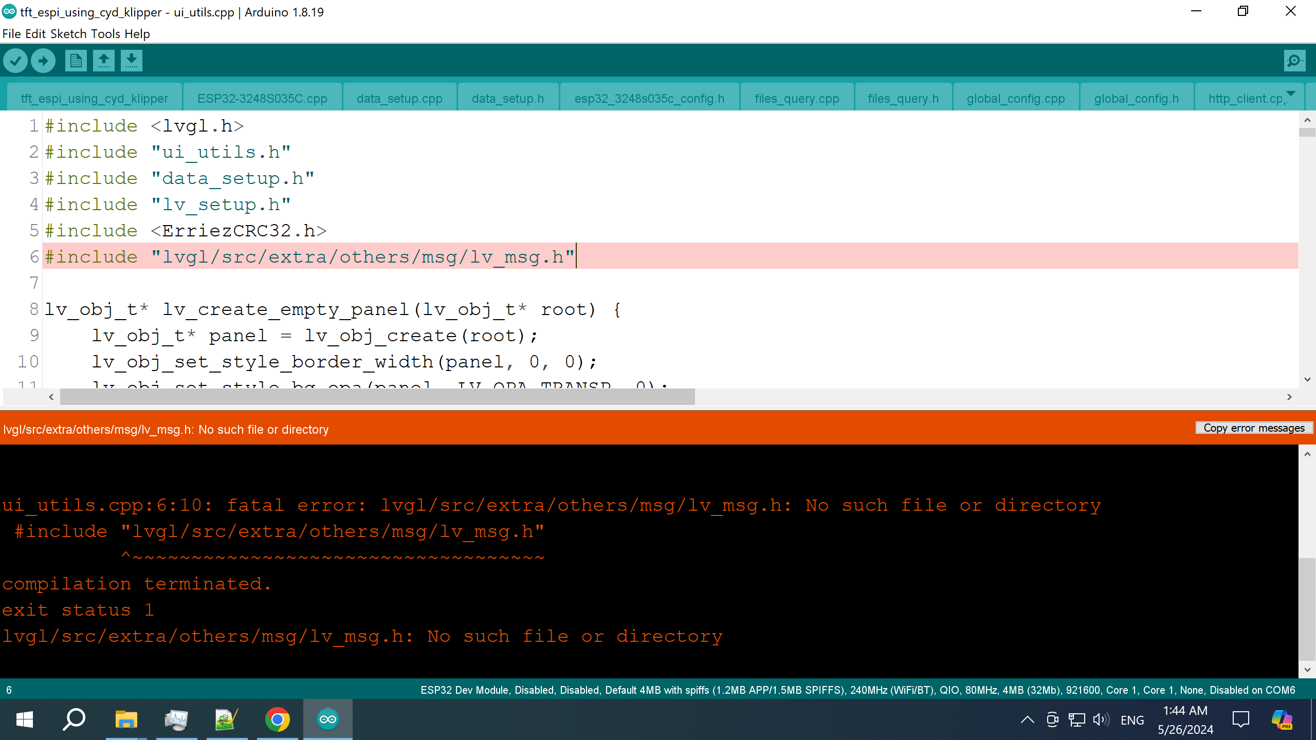

Here's another issue:
The lv_msg.h is inside lvgl library as I want to access LV_EVENT_MSG_RECEIVED which is defined in this file.
So I used this path:
#include "lvgl/src/extra/others/msg/lv_msg.h"
I assumed that the arduino system requires the name of the library first, then I should stage into the nested folder but I don't know why it isn't working as exptected.
Since you have already included lvgl.h, try the relative path <extra/others/msg/lv_msg.h>

You're using IDE 1.x, which I am not familiar with. But generally, there are two directories with libraries:
  • the installed Boards and their built-in libraries
  • add-on libraries, populated by the Library Manager
Both of these contain dozens and dozens of directories that can be individually enumerated as search roots during compile time. There is no exhaustive search through those two trees, or considering library names. For example, if you use the Library Manager to install lvgl, then libraries/lvgl/src is added as one of many include directories to search.
When you #include <lvgl.h> that file is found -- the one in src. (Note there is also one in lvgl. The one in src is mainly
#include "../lvgl.h"
#include "lv_conf_internal.h"
so it includes lvgl/lvgl.h) Given this, you should use.
#include "extra/others/msg/lv_msg.h"
as already suggested. (I don't have a src/extra directory in my v9.1.0 copy of the library, though.) Remember, this is a search through dozens of include directories, and the first match wins. So if the name is not sufficiently unique, you could get something else.

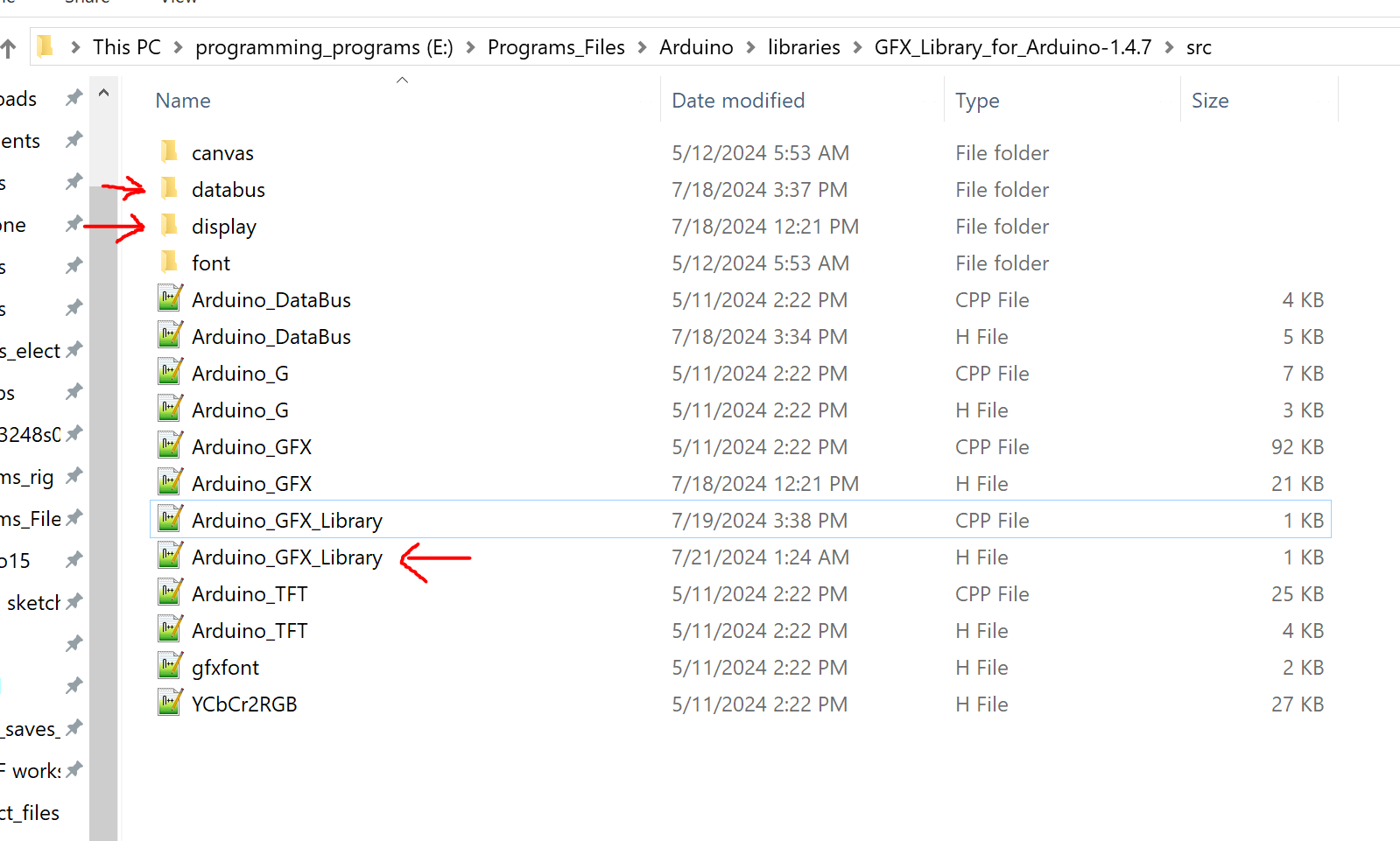

OK guys I found a working example in:
C:\Programs Files\Arduino\libraries\GFX_Library_for_Arduino-1.4.7\examples\PDQgraphicstest
Uncomment the model you have an enjoy :slight_smile:

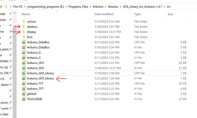

I'm workig with another library and applied the technique you told me and it worked.
When I include the master header file, I can include the other libraries in the sub-folders.
With this:
#include <Arduino_GFX_Library.h>
#include "../src/databus/Arduino_ESP32RGBPanel.h"
#include "../src/display/Arduino_RGB_Display.h"
