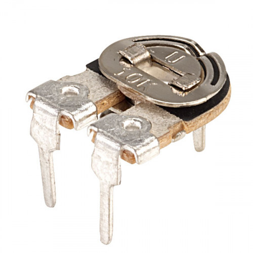

Hi, I was testing this, built the whole circuit, then I smelled smoke and noticed my preset was sparking.
What I did? the preset has three pins, the single lonely pin I connected to the 5V and one of the two pins I connected to GND and the second of the two pins I connected to as shown. The preset is sparking when I turn it to the extreme end to reach zero volts at T1. Why?
I'm not sure what you mean by preset. Do you mean the variable resistor R6?
Yes the variable resistor, 50K. This is what I am using. The image is of 10K but I am using 50K.
Connect like this
