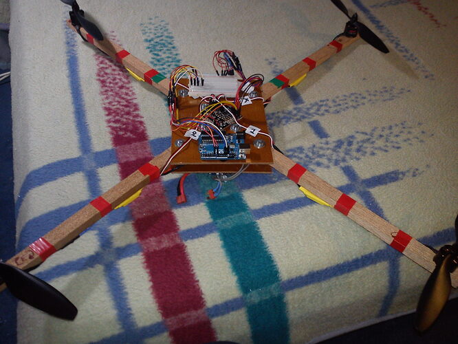

Hello I am building a quadcopter. Basically I have done this and today i did the first flight using a transmiter and a receiver in the quad that was giving / saying to the flight controller what to do. I am trying to do something like that using an arduino So there is the following setup.
My problem is that I can not ARM and DISARM a flight controller from Arduino ? I used to do this by moving the stick of my transmiter to the down left corner.

kkmulticopter.kr this one.
I know that i have to give 0 THR and MAX RUDD but dont know how.

Are you using the Servo library to control the AIL, ELE, THR, and RUDD inputs of the flight controller? You just have to figure out which two servo outputs to set. I guess THR to 0 and RUDD to 0:
    // Arm flight controller
   ThrottleServo.write(0);
   RudderServo.write(0);
   delay(2000); // Wait for the flight controller to recognize the ARM command
   RudderServo.write(90);  // Return rudder to center position.
Exactly but its not working.
That doesn't sound like 0, 0
I have given 0-0 0-1500 1500-0 and more. None of them is working :S

Assuming you're using writemicroseconds and assuming (again) that you're using 'standard' servos, fully down and fully left sounds like 1000,1000 to me. 1500 is a center position so that's unlikely to do you any good. Of course, as AWOL says, depending on your servo arrangement, either one of those 1000s might need to be 2000. Experiment!

If you want to use writeMicroseconds() that would be:
   ThrottleServo.writeMicroseconds(1000);  // MIN Throttle
   RudderServo.writeMicroseconds(1000);  // Full Left Rudder (use 2000 for Full Right Rudder)
   RudderServo.writeMicroseconds(1500);  // Return rudder to center position.
Thank you i ll try that. Btw this is my quadcopter: VIDEO
THANK YOUUUUU!!!!! :smiley: Its is working. :slight_smile: Now i can do whatever i want !
