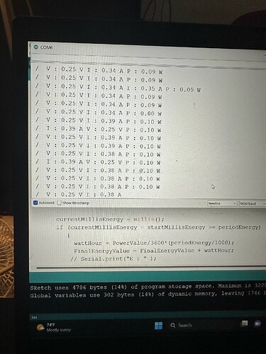

How to Better Display my Results on Serial Monitor for Data Collection
Hi all,
Beginner coder here. I'm working on a project to collect data off a 12V DC battery. I need to collect Voltage, Amps, and the code will calculate Power, Watt-Hours, etc. Everything is working correctly on the hardware side and with the code as well, I just need to know how I can best display my results on serial monitor for data collection. I was copying and pasting my data into Excel, and some lines of the serial monitor switched the positions of volts and amps, and with 3000+ data points I can't manually swap all of the faulty data points.
I need my serial monitor to be impeccable when displaying my results. I've attached a copy of my serial monitor and code below.
Thanks in advance, I'm sure this is simple but I am a new programmer. Would appreciate any advice!

            Serial.print("V : ");
            Serial.print( finalVoltage,decimalPrecision);
            Serial.print(" V ");

           Serial.print("I : ");
            Serial.print(finalCurrent2,decimalPrecision);
            Serial.print(" A ");

            Serial.print("P : " );
            Serial.print(PowerValue,decimalPrecision);
            Serial.print(" W ");
            Serial.println();
          Serial.print(" /  ");

Plenty of colors and nuances for ease of reading ! Especially when lots of comments and commented out code...
When you convert to and operate with floating point, a bit of unavoidable error can creep in. Integers can lose data to rounding but with large integers we can cleanly add places to integers to lose in scaling, keep 3 places by working to 6 or more through tiny working units. Millimeter integer is just meters to 3 places. If you need 3 places to lose to round-downs then work to micrometers, the next three places go nano. 32 bit unsigned longs deliver 9 places 0 to 9 and 64 bit ULL have 19 places.
Work with integer reads and only display or generate the human-read output at point of need. At least you don't show more places than the hardware is good for!
You have too many millis timers.
Your periodEnergy and your periodPower are the same, but they will not be printed always in the same order, since millis() can change while going through the loop() function.
I think that the goal is a single line with all the data.
That means you need a single millis timer to print all the data.
You should not use millis() like this: if (millis() >= currentLastSample + 1)
To average a value, you can take 5 to 1000 samples without delay. That will get rid of the electronic noise just as well.
If you want to capture data during 1 second with some spacing between the samples, then you could use millis(). I think it is safer to check if millis() has changed.
unsigned long previousMillisSampling;
  if (currentMillis != previousMillisSampling)  // has millis() changed ?
    previousMillisSampling = currentMillis;
    voltageSampleSum += analogRead(VoltageAnalogInputPin);
    voltageSampleCount++;    // increment number of taken samples
    currentSampleSum += analogRead(CurrentAnalogInputPin);
    currentSampleCount++;
To print data, use a single millis timer:
unsigned long previousMillisPrint;
  if (currentMillis - previousMillisPrint >= 1000UL)
    previousMillisPrint = currentMillis;
    calculate voltage and print it
    calculate current and print it
    calculate power and print it
    calculate energy and print it

Thanks for the response! I've been playing around with the code you've provided, and made good progress. My serial monitor is printing results fine, but now my current measurement is no longer accurate. It's displaying values between the range of -0.10 to .10 when there is zero current applied. I'll provide my new code per your suggestions below. Any idea how to fix this issue? Thanks again for your response very helpful.

What are the raw data values you are measuring? You can always expect a little jitter in the LSbit.

About Serial baud, and Serial Monitor - setting the baud rate low means the already-printed values, etc. take a long time to get transmitted. As a result, since your output string is long, it's possible your output buffer will fill, and at that point serial printing is a blocking process; that will delay your measurement cycle. Increase the baud rate, and your buffer empties quickly. Possibly, still slowly enough that your cycle is impacted, but it should be much less.
The real solution would be to not print the entire line as a block, but rather do the printing piecemeal, but I don't think it's necessary to add that complication. I added the last sample count printout in the printout routine(but commented it out) so you could keep an eye on that; if it's low, or drops, you'll need to rethink printing.
Okay so after testing a few times, no current is being measured by your code. Voltage works fine, but something is happening where no current is being registered by my Arduino. I'm going to play around and try to figure it out, but otherwise the code is much better than what I was using previously. Any ideas why current isn't registering?
Thanks for taking the time to answer and type out the code for me, I really appreciate the guidance!
Try an extra print statement, printing just the raw current value.
