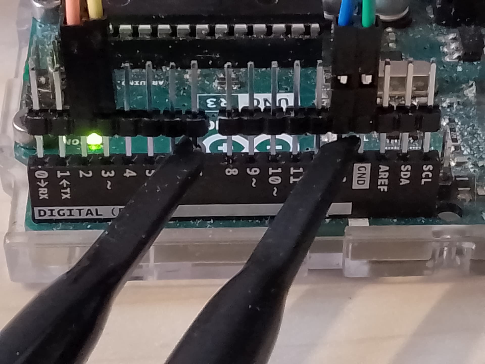

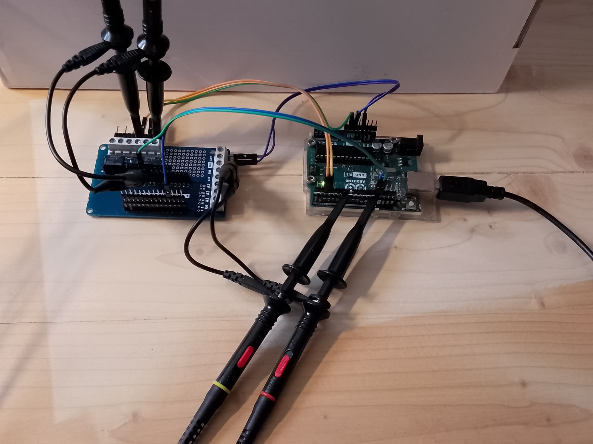

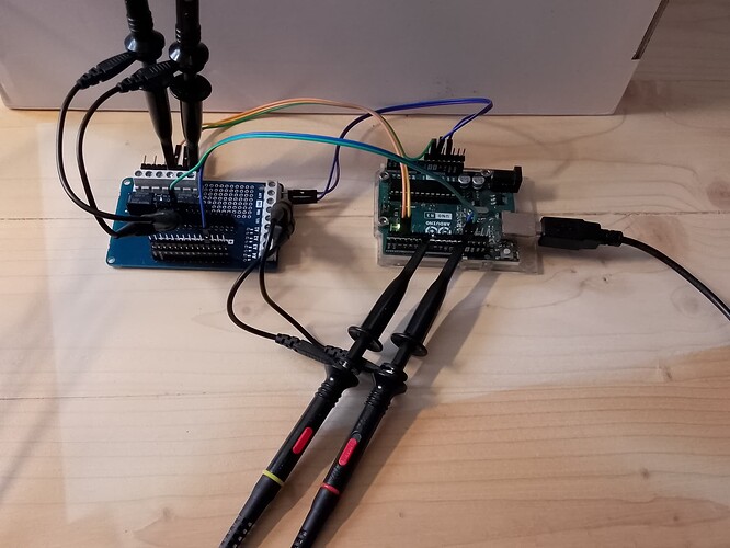

Here is how I had things connected:

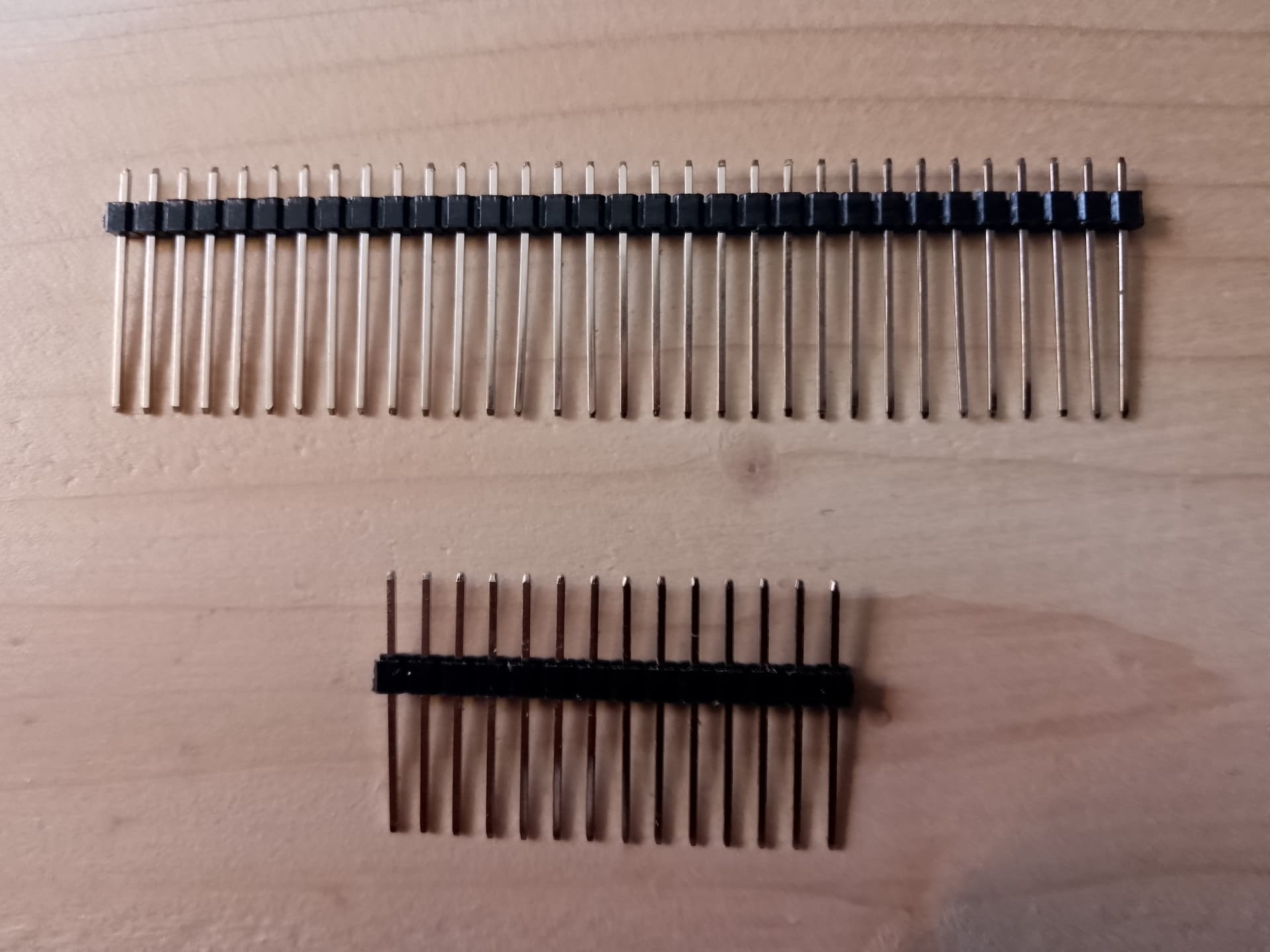

To aid connection I use this type of strip of pins:
They are supplied like the upper row, but I push the pins through to make them like the bottom row.
When the longer end of the pins are inserted into the connectors on the Arduino, you can plug a Du-Pont type connector above the black insulator, and clip an oscilloscope probe lower down between the insulator and Arduino.
I have used the same type of strip of pins, with every second pin removed to connect to the screw terminals.
My relay coil voltage is 24V and I have set 24V in the power supply.
Then you have no need for the 3.3V.
But you will need a MOSFET or BJT to switch the relay, and a reverse biased diode across the relay coil.
Mine is already on the Arduino MKR Proto Shield:
My Arduino pin 13 connects to the CMD2 pin that goes to R4, to switch T1-2 and RELAY2.
From the hardware it is difficult to understand. Can you please provide the connection diagram.
