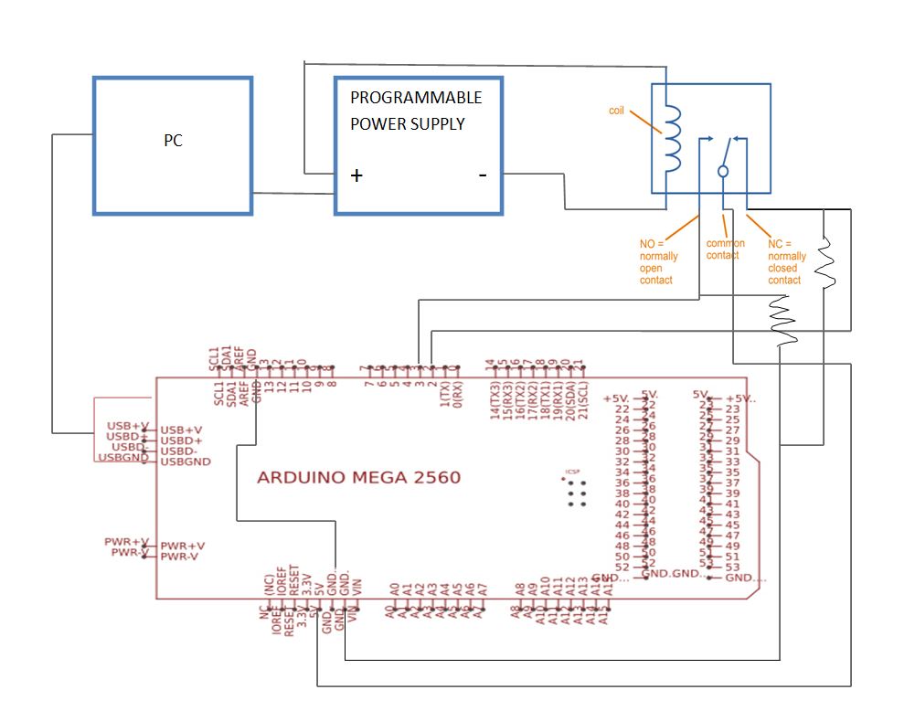

How to calculate operating time of electromechanical relay using arduino mega board
I have connected 5V of arduino board to common of the relay and NO and NC pin of relay are connected to two digital pins. Also NO and NC are pull down using 10K ohm resistor. I have to calculate the operating time. I am getting some deviated result with my code. Help me with the code.

Also NO and NC are pull down using 10K ohm resistor. Why are you using pull-down?
What is driving the relay?
how do you change the state of the relay by applying power to the relay coil?
why not measure either
  • the the time from when power is applied to the coil and the NO contact closes, or
  • the time when power is removed and the time the NC contact closes
bear in mind, the arduino needs to know when coil power changes, so most likely use a switch to command the arduino to start the process
Do not forget the relay can bounce.
It is always the contact that is closing that bounces.
When the relay is energised the NO contact bounces.
When the relay is de-energised it is the NC contact that bounces.

If possible, please provide me the connection diagram.
i'm guessing that you expect the PC to control the relay.
from the code it looks like you expect to make a measurement from when the NC contact opens and goes LOW to when the NO contact closes and goes HIGH.
i assumed you want to measure the time from when the coil is energized. that requires that the Arduino control it and that is the purpose of pin 13.
i wired things so that i could test the code on my hardware. if you understand what i've done, you should be able to modify your code to better suit your approach
what does this mean? can you post your results
since your pull-down resistors are wired to Gnd, your common should be wired to 5V
looks like you're measuring from when one contact opens until the other contact is closed
do you want to measure from when the coil is energized until the contract open/closes?
so how does the arduino know when the coil is energized ???
the common terminal is only for the contacts.
the coil is independent of the contacts

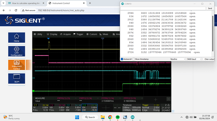

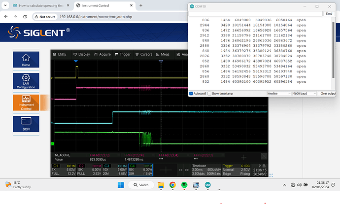

I did a test to see how well the results obtained from gcjr's code agreed with the results obtained from an oscilloscope.
I modified gcrj's code slightly, so that it would wait until I gave it a trigger signal before it switched the relay on or off. This was done to give me time to save the results before the next switching event.
The oscilloscope traces show:
  • Channel 1 - yellow trace - trigger signal
  • Channel 2 - red trace - relay power
  • Channel 3 - blue trace - NC contacts
  • Channel 4 - green trace - NO contacts
  • There are automatic measurements of the times being measured
The Arduino results on the serial monitor are shown on the same screenshot.
The last result on the serial monitor is the same run that the oscilloscope trace shows.
Relay turning on:
Results:
Arduino 852µs 1484µs
Oscilloscope 853µs 1481µs
Relay turning off:
Results:
Arduino 2724µs 3152µs
Oscilloscope 2723µs 3150µs
The results obtained from the Arduino are very close to the results from the oscilloscope. There is a maximum difference of 3µs between the Arduino and oscilloscope in the results shown.
Both the Arduino and the oscilloscope measure the time to the beginning of the contact bounce. The bounce time is extra.
Arduino micros() rounds (I forget if up or down) to 4's.
The low 2 bits are always 0.
