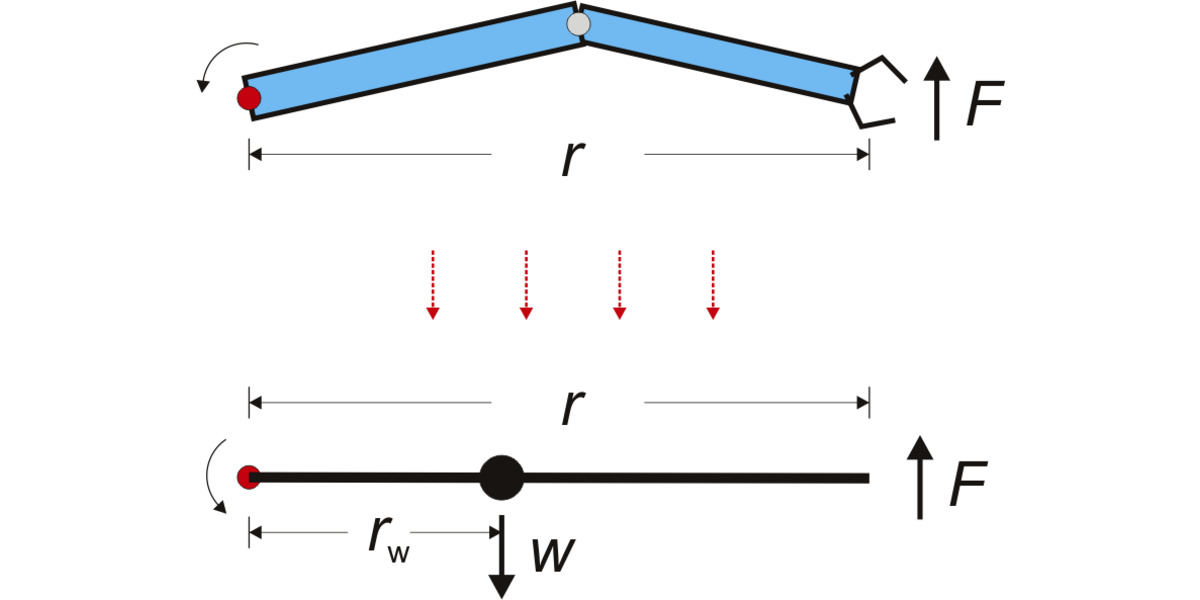

I would assume in the "real world" where you are driving some sort of mechanism it's almost impossible to make an accurate calculation. In the real-world, you're rarely just turning a flywheel or lifting a constant weight or anything that's simple to calculate.
You might be able to calculate an approximate value, but I think you'd have to measure the required torque (which may not be easy either, especially if you don't have some kind of motor) or make a guess/estimate and then try just it.
You may be able to calculate the amount of work/energy for whatever you are ultimately moving, and then throw-in an allowance for inefficiency/loss in your mechanism/gearing/pulleys/whatever. Steppers are less forgiving than most motors because you can loose a step or slip a step without knowing it. So, you've probably got to over-design.
Overview of force and torque
