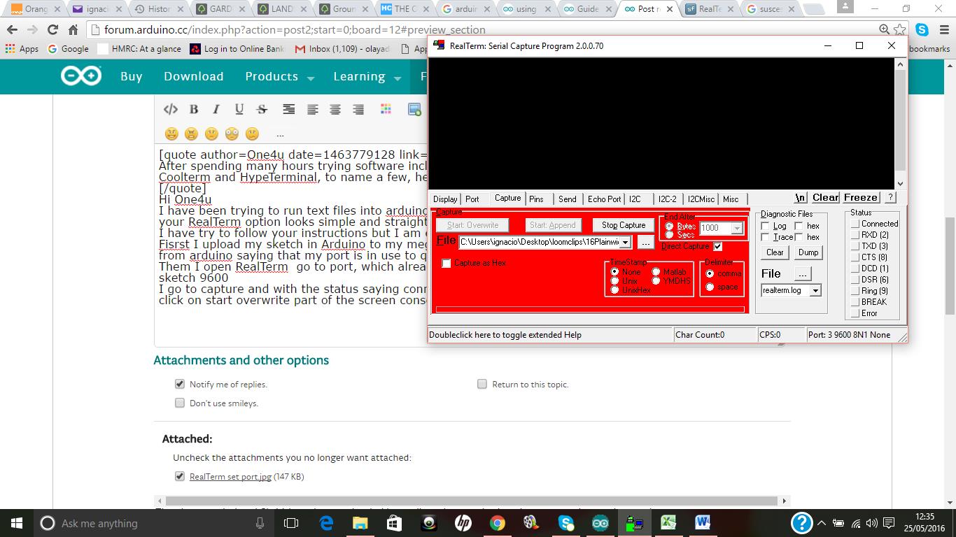

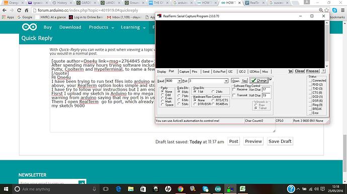

Can you see in the pictures attached, what I am doing wrong why the text file shows no char count when I press start overwrite or start append?

this seems really useful, but do i need to change any settings in the Display tab at all? and i basically have all the same settings in Port and Capture tab as user ignacioandcorral...
(only bytes have more zeros, but dunno if that affects anything or not...)
and it should not display anything in the black window anyway with the Direct capture option? ::slight_smile:
