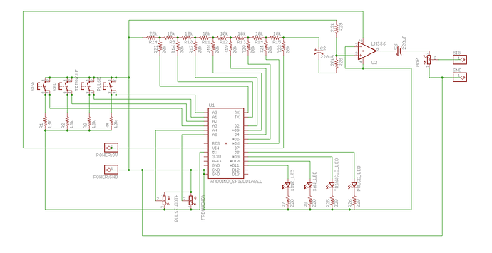

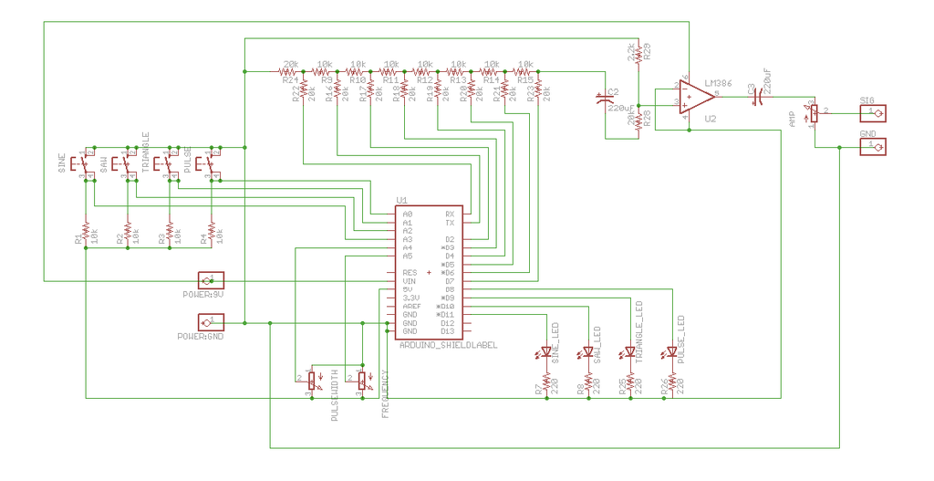

I entirely agree Mike, the OP is trying to achieve something fairly trivial in an "old school", inefficient and un-necessarily complicated way. As @horace said, just do it this way
or if the OP REALLY Just wants to use an esp32 there is this - fully documented and sensible.
Every ESP32 is many times faster than an AVR.
Arduino Due has 2 DACs to do true audio quality analog-out.
If you read at the end of that destructible;
You will notice that the pulse wave is the only wave which truly ranges from 1Hz to 50kHz. Since the sampling rate is 100kHz, the sine, triangle, and saw waves start to become somewhat unrecognizable at about 25kHz (they are only comprised of 4 samples per cycle- 100kHz/25kHz). The saw and triangle waves only go down to about 100Hz, this is because the values of triInc and sawInc get so low that they are rounded to zero below this frequency. The sine wave reaches all the way to 1 HZ but the resolution stays the same for anything under 5Hz, since the Arduino only has enough memory to store about 20 thousand samples.
Also the 200 replies....
Have you built this circuit?
I do not, I practicing ESP32
Can you post a schematic PLEASE.

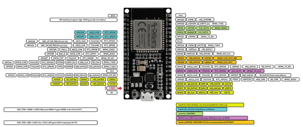

I am using this board , pins are described in the sketch
https://pt.aliexpress.com/item/1005006259553219.html
