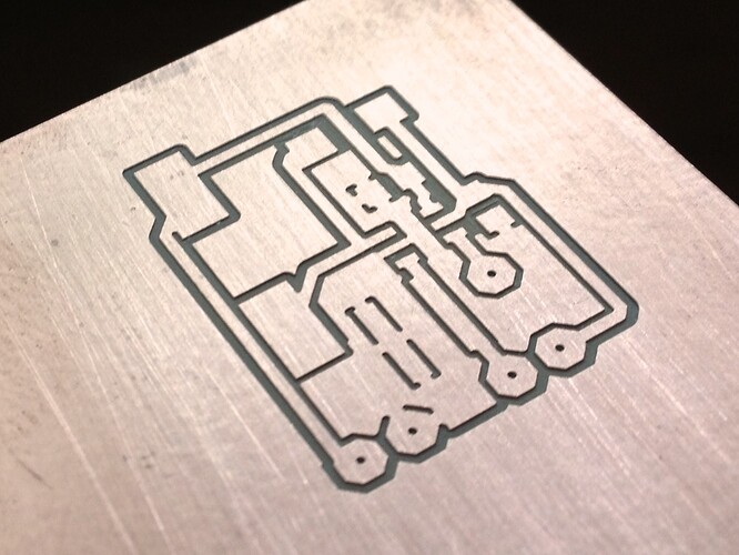

Success!
I milled out a quick PCB (milling boards can take ages, but this one was only 5 minutes; can't beat that with etching):
