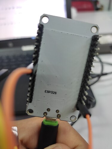

what ESP32 board are you using?
My Board is ESP32 Wroom behind wrote ESP32S but the chip is wroom

what ESP32 board is it?
this is my board infront of the chip wrote ESP32 Wroom but behind is ESP32S
