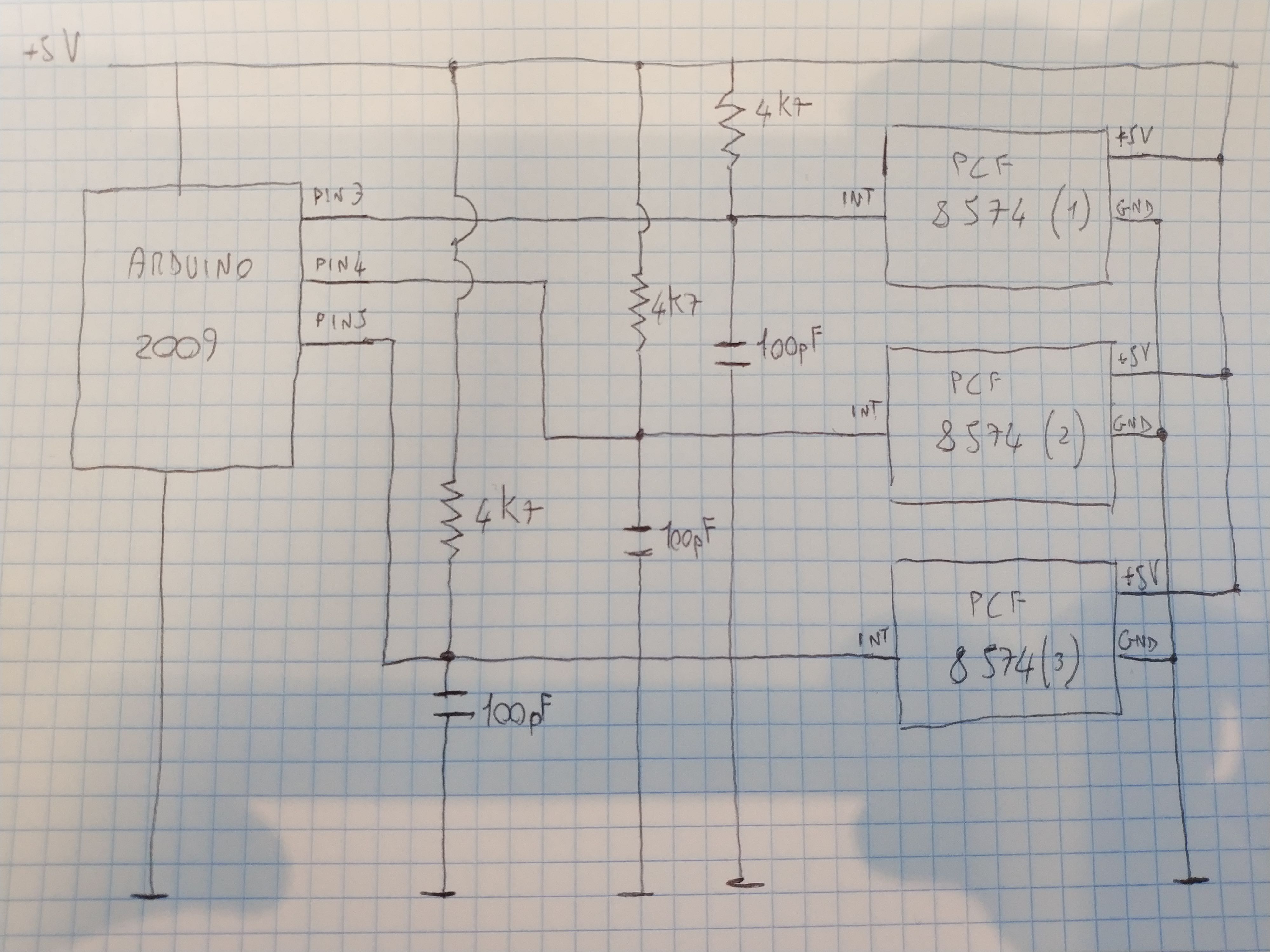

So, I have 3 digital pins on my Arduino 2009 which are meant to read the interrupts of the 3 different pcf8574s.
Now, all seems to work fine for the first pcf8574 (the one connected to digital PIN 3), however the other 2 seems to never trigger the interrupt when a button attached to them is pressed.
If I connect any of the other boards to PIN 3, then it works... so I was wondering if I'm making any mistakes in how the pcf8574 interrupt pins are connected to the arduino board.

and secondly a sketched schematics just to give you an idea about how I connected the interrupts to the arduino
Hello there!
According to the information page on the Duemilanove, the only two pins that can accept an interrupt are digital pins 2 and 3. You have one pcf module connected to pin 3, and that is the one that is working as intended. The other two do not, as those pins cannot handle interrupts.

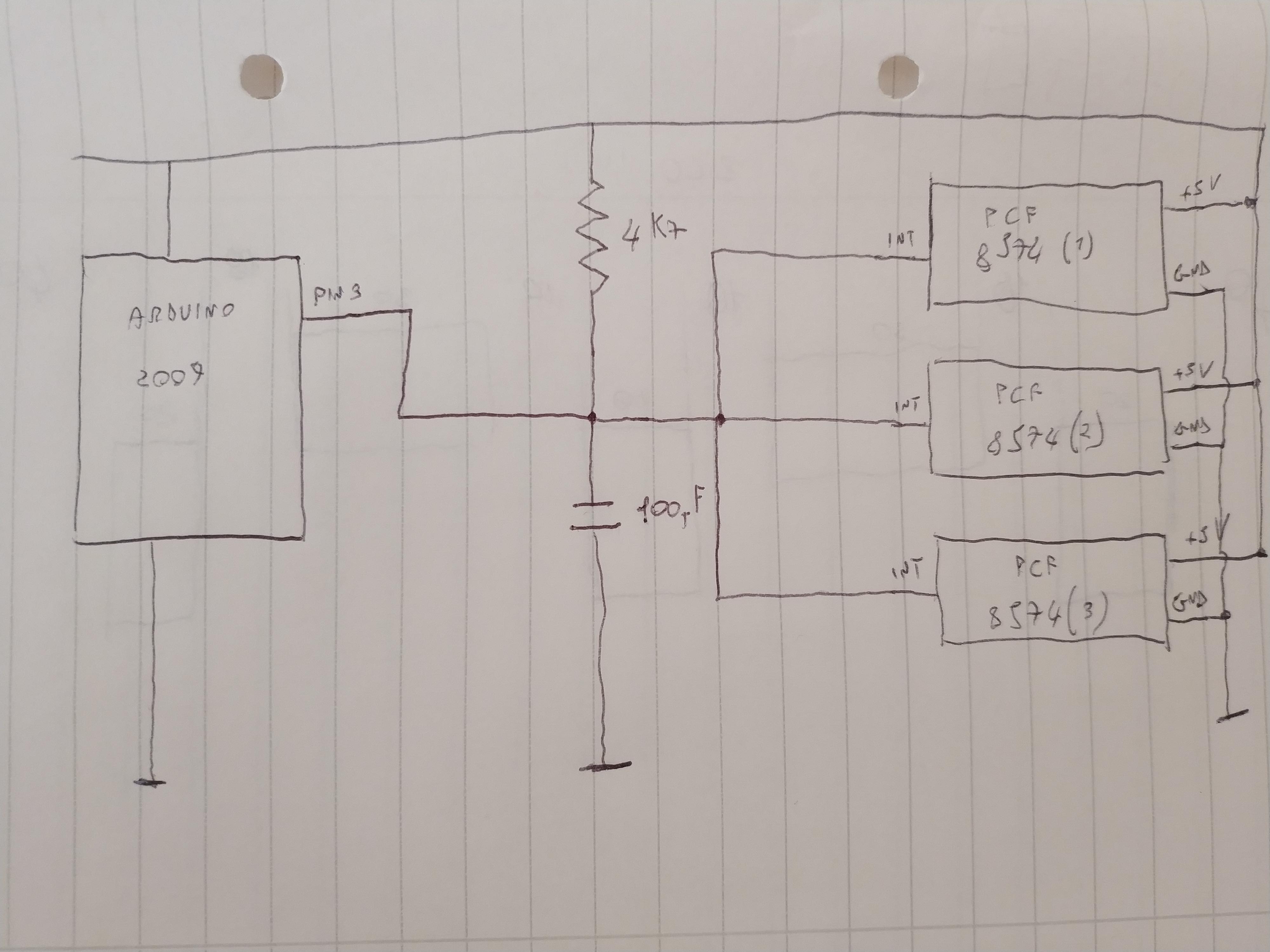

Hi septillion,
thanks for your reply.
When you say "in parallel", you mean something like this?
If that's the case, I'm don't get how you would differenciate between an interrupt coming from pcf8574 (1) or pcf8574 (2).
I'm sure I'm missing something here...
Regarding using interrupts, I'd like to give it a go, it's the first time I use them and I'd like to experiment a bit. Anything in particular I should be aware of?
Thanks,
Gab
That's indeed what septillion meant. You can't differentiate; once an interrupt happened, you know that one of the three PCF8574 caused an interrupt and you can read all three PCF8574s to get the state of all buttons.
