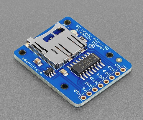

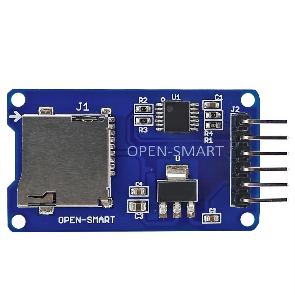

  1. Your SD card does not include voltage translators, so you should not connect it to your Nano.
    Buy a module that has the voltage translators.

The modules with the 3.3V to5V translators will have another IC on them.
Here are two examples.
It works! You are the best of the best! Thank you so much!

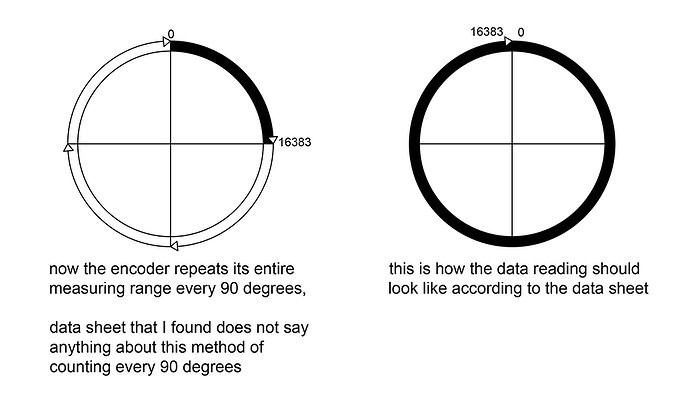

If I may, I have another question. These encoders give values ​​from 0 to 16383 every 90 degrees, not 360 degrees, the data sheet does not say anything about this operation, what could this be an issue of, or do I just have to include it in the code, divide it into quarters?
Post the code you are using to read the data and compute the angle
I use the calculation as below, but that's not the problem.
 uint16_t currentValue = readAngleData();
 float baseAngle = (currentValue / 16383.0) * 90.0;  // 360 as if he was measuring every 360
I'm uploading a drawing that shows what the problem is, maybe it's the encoder version that counts like that, unless there's another reason?
What is readAngleData();
Maybe you are reading the angle wrong.

That's wrong
The upper byte is in register 3 the lower is in 4.
You need to shift the upper byte left by 6 and the lower byte right by 2 then or them
That is too fast. Max is 15.6MHz.
I would set it to 8MHz.
Yes! 6MHz is stable and this is what the corrected lines look like:
  uint8_t highByte = SPI.transfer(0x03);
  uint8_t lowByte = SPI.transfer(0x04);
uint16_t result = (highByte << 6) | (lowByte >> 2);
Thank you a hundred times again!
