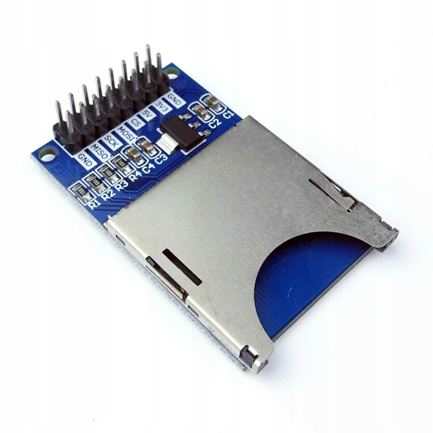

Encoders work great! However, the SD card reader refuses to work. I also connected via 74hct125, but it does not initialize the card, if I disconnect the MISO encoders, the card is initialized.
There are dozens of SD readers. Some people have problems with certain versions.
Which do you have?
Is it 3.3V or 5V?
Make sure that the CS lines for each encoder is high, That should automatically disconnect the encoder MISO line.
I have a 3.3V and 5V reader, but during testing only 3.3V gave correct file saving. I noticed that when I initialize the CS encoder pins in the setup function before initializing the SD card, the card reader works and saves correctly, but the encoder does not, it shows the first reading phrase and the next ones are zeros.
This is the reader as in the picture below:
And these are the setup function settings:

Which sd card library are you using?
Which pins are you usinf for the 3 chip selects?
