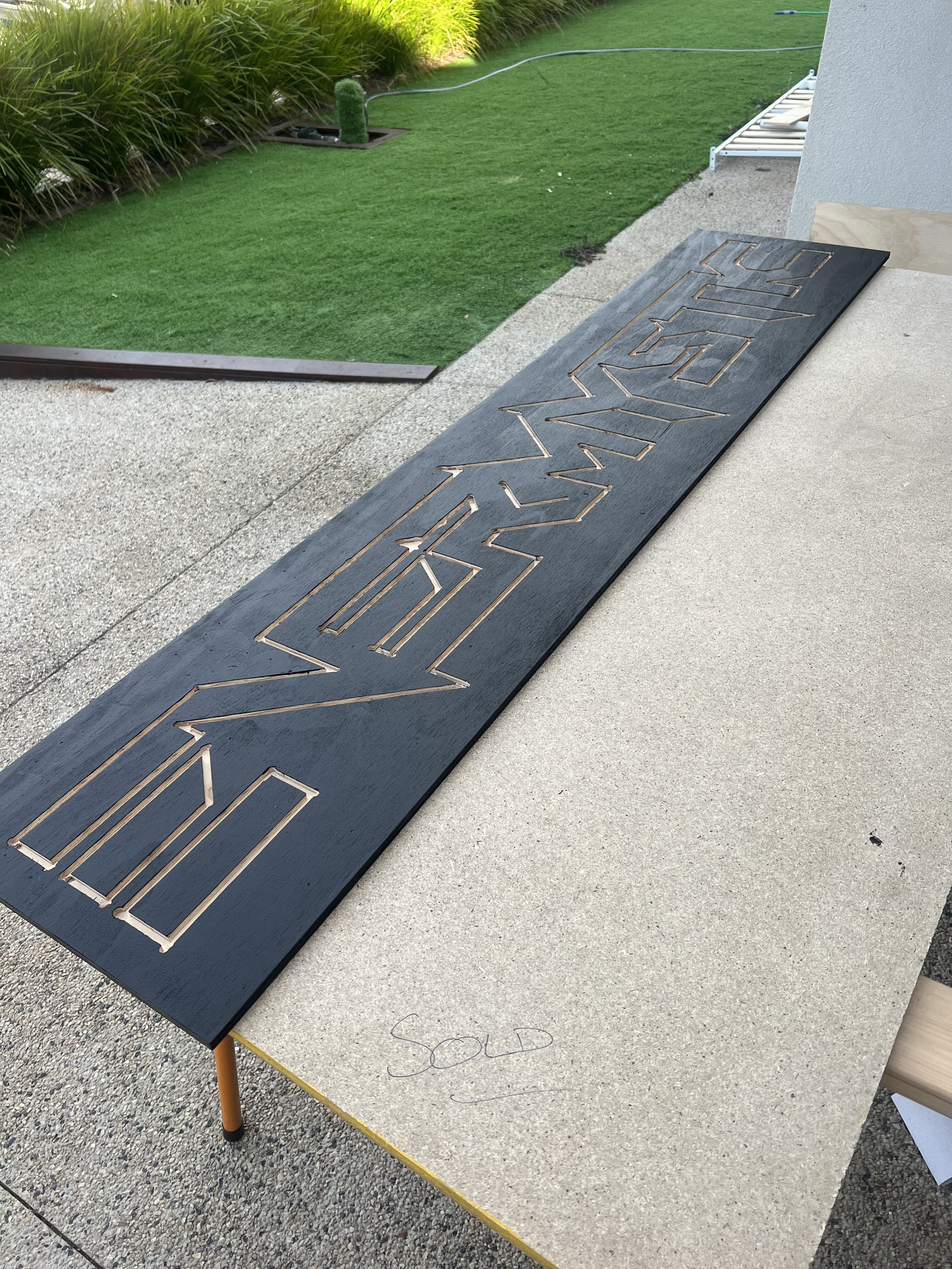

I have a sign made of 6 peace’s that make up a word EVERMYSTIC , how can I display each letter when all leds are in basically one strip connected together ? For example when I have part of E. Bottom , middle and top would be different parts of the strip, how can I code to turn all those parts on and off to make up that letter ? Thank you

I’m using WS2811 12V LED strip

Yes . So if I want Y for example it would be something like: 120 to 150 and 340 to 360 and so on, so I can just turn parts of the strip on and have them In a variable Y for example so I can Always just turn letter Y
Putting a set of ranges in a variable is not impossible but it is a bit complicated. I would have a function for each letter:
void LetterY(CRGB color)
  for (int i=120; i<=150; i++)
    strip.setPixelColor(i, color);
  for (int i=340; i<=360; i++)
Note that I don't know what library you are using so I can only guess what functions are available.
If you define every character as a small 5x9 matrix, you can make one general function (assuming you have 9 lines in your matrix).

Please confirm that the LEDs are in a matrix or, if not, then exactly how they are arranged
1 continuous strip connected with 6 pieces of cuts together
Please share a picture. You seem to have only 6 lines. That will not make very nice characters...
But it could do...

Your code could have a 2D array of how the bulbs are arranged physically where the value at each row&column is which led number in the fastled array which is 1D. How you make letters... it takes 48 pixels to make a single 6x8 char and my 2811's came 50 per string! Center to center, perhaps 25mm-30mm on black background.

Ok, so no matrix...
Just make a list of ledNrs per character and do as suggested by john wasser.
Your software can keep an internal matrix just to map 2D physical positions to actual led numbers.
You know about 2D arrays, row and column is good old X and Y?
You have to do some abstracting here, model the reality of leds you wired and placed. Get it right once, works forever!
