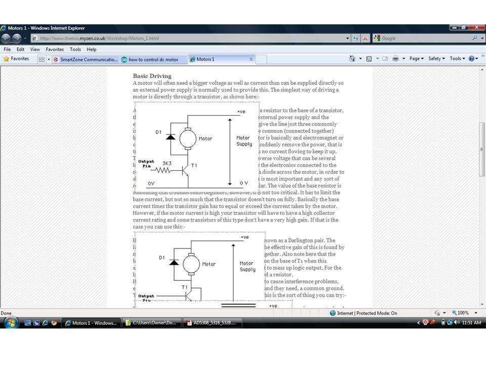

you can't wire up a motor directly to a pin you need some sort of driver. See this link:-
http://www.thebox.myzen.co.uk/Workshop/Motors_1.html

You need a transistor and a diode (and those are rather cheap). Look at the first scematics on the page Mike has linked to.

why would I need a diode? the motor is not a power source therefor will power back the arduino
wouldnt a diode be useless in this scenario?
Well, you may or may not destroy your transnstor without one. The laws of physics generally ignore wishful thinking.
