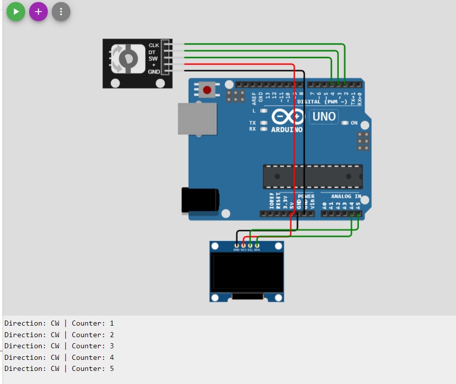

How to convert using buttons to using encoder OLED
As I wrote in the topic, user upir created a great tutorial (Arduino OLED Menu Tutorial (for beginners - Arduino UNO, 128x64px SSD1306 OLED screen, u8g) - YouTube) to create a menu using the u8glib library. I would like to replace the buttons in his code with the use of an encoder (pins S1, S2, Key, 5V, GND). I don't know what I'm doing wrong but I've tried several times and the options in the menu keep jumping. I checked the encoder on another code and it works normally. So my question is how to convert the use of buttons to movement with the encoder?
Basically you change the code to take into account your new requirements.
However not knowing what you have done already or what is connected to what makes being more specific hard.
Please post your code in code tags and a schematic of your circuit, hand drawn is fine, Fritzing is not.
Also read the how to get the best from this forum sticky post.
Ok, so i wanted to just check how the encoder works. So i change a little bit the source code.

And my question is why if I move the knob to right or even to left it's just typing me the moving CCW dirrection. Like on pic:
Pity you ignored that bit, it would have told you how to post code correctly.
I'm sorry, i'm getting better code below:

// encoder setup
#define CLK 2
#define DT 3
#define SW 4
int counter = 0;
int currentStateCLK;
int lastStateCLK;
String currentDir ="";
unsigned long lastButtonPress = 0;
u8g.setColorIndex(1); // set the color to white
// define pins for buttons
// INPUT_PULLUP means the button is HIGH when not pressed, and LOW when pressed
// since it´s connected between some pin and GND
pinMode(BUTTON_UP_PIN, INPUT_PULLUP); // up button
pinMode(BUTTON_SELECT_PIN, INPUT_PULLUP); // select button
pinMode(BUTTON_DOWN_PIN, INPUT_PULLUP); // down button
// Set encoder pins as inputs
pinMode(CLK,INPUT);
pinMode(DT,INPUT);
pinMode(SW, INPUT_PULLUP);
// Setup Serial Monitor
// Read the initial state of CLK
lastStateCLK = digitalRead(CLK);
//encoder moving
// Read the current state of CLK
currentStateCLK = digitalRead(CLK);
// If last and current state of CLK are different, then pulse occurred
// React to only 1 state change to avoid double count
if (currentStateCLK != lastStateCLK  && currentStateCLK == 1){
	// If the DT state is different than the CLK state then
	// the encoder is rotating CCW so decrement
	if (digitalRead(DT) != currentStateCLK) {
		counter --;
		currentDir ="CCW";
		// Encoder is rotating CW so increment
		counter ++;
		currentDir ="CW";
	Serial.print("Direction: ");
	Serial.print(currentDir);
	Serial.print(" | Counter: ");
	Serial.println(counter);
// Remember last CLK state
lastStateCLK = currentStateCLK;
// Read the button state
int btnState = digitalRead(SW);
//If we detect LOW signal, button is pressed
if (btnState == LOW) {
	//if 50ms have passed since last LOW pulse, it means that the
	//button has been pressed, released and pressed again
	if (millis() - lastButtonPress > 50) {
		Serial.println("Button pressed!");
	// Remember last button press event
	lastButtonPress = millis();
// Put in a slight delay to help debounce the reading
delay(1);
// when pin 13 is LOW (DEMO_PIN), enable demo mode
// this could be done either by using a switch
// or simply by connecting the wire between pin 13 and GND
// (those pins are next to each other)

Thanks that is the full picture.
The way I see it is that you are not reading the rotary encoder fast enough. Once you add extra stuff to your loop then it slows down the frequency you can read the rotary encoders.
The best bet is to use one of the rotary encoder libraries you can get. Unfortunately they are not all done in the "correct" way so you can still get problems.
However one that does read encoders correctly is this one:-
Encoder Library, for Measuring Quadarature Encoded Position or Rotation Signals
I would try this first and just read the count you get from it and see that it works first before you try and include it into your code. It uses interrupts so it still counts when ever the contacts of the encoder changes despite what the other code is doing.
Look at the examples that come with the library, to do things like reset the count.
Please edit your post #3 to add tags </> because is hard to understand what's code and what is explanation.
The encoder response is not fast enough because you are not using interrupt.
Try this:

// encoder setup
#define CLK 2
#define DT 3
#define SW 4
int counter = 0;
Rotary r = Rotary(DT, CLK);
void encoderA() // DT
  unsigned char result = r.process();
  if (result == DIR_CCW)
    counter--;
    Serial.print("Direction: CCW");
void encoderB() // CLK
  if (result == DIR_CW)
    counter++;
    Serial.print("Direction: CW");
  pinMode(CLK,INPUT);
  pinMode(DT,INPUT);
  attachInterrupt(digitalPinToInterrupt(DT), encoderA, CHANGE);
  attachInterrupt(digitalPinToInterrupt(CLK), encoderB, CHANGE);

Hi, today I used this library. Code below:
#include "U8glib.h"
#include <Encoder.h>
Encoder myEnc(3, 2);
U8GLIB_SSD1306_128X32 u8g(U8G_I2C_OPT_NONE); // Fast I2C / TWI

And link to project wokwi : Menu Oled Rotary - Wokwi Arduino and ESP32 Simulator
I make sollution to make encdoer left and right by this library but i still have problem because the menu is jumping over and over i don't know why. Please help :slightly_frowning_face:
I used this code but it's not working. If i switch encoder on monitor is nothing changed. I installed library which you paste on code.

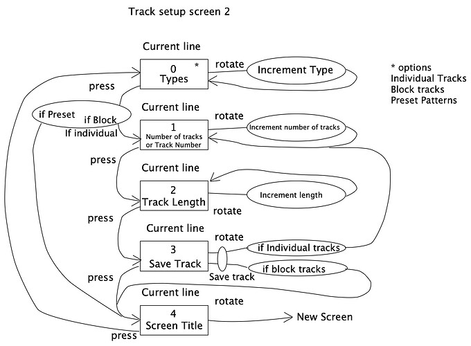

One good way of getting a handle on what you need is to draw it out as a diagram.
I recently did something rather similar but I was working in Python so the code is not directly applicable to you. It was for setting up parameters in a MIDI sequencer.
Basically I had an extendable list of menus, each menu had five items. The logic I used was that a push on the button would change the active line on the menu as displayed by an arrow next to the line. Any rotation of the encoder would cause an action changing a variable for that line. When a menu screen was first entered it was always on line 4, being displayed at the top of the screen and was the menu change option. So a rotation would always take you to the next menu, when you reached the end of the menus it would wrap round and show the first menu again.
If on any menu you pushed the encoder button it would go to line 0, and a rotation would then alter that parameter in either a wrap round way or a move to a limit and then go no further, but would move back from there if you turned in the reverse direction.
This was my state diagram for one menu screen.
A state diagram is a sequence of states shown in boxes and the transition from one state to the next is shown by an action and where that action leads, hence the basic series of pushes showing it going from one line to the next. But note the rotation also does stuff as well. Look up a state diagram it is a real thing and will show you more about how they are constructed.
What you can get with this code?

Nothing shows on serial port monitor when i rotate the encoder. On Arduino IDE it shows that the program is loaded. The pins are also properly initialized according to Pin 2 and Pin 3.
Try the example directly from Rotary library.
Are you using Arduino uno?
Not a great one for using simulators, when I try and run this I get an error
sketch.ino:2:10: fatal error: Encoder.h: No such file or directory
When the menu jumps about, is it doing this when you turn the knob or does it jump without you turning the knob?
If it does then it implies it is not wired up correctly, that is something on your bread board is not making proper contact and so you have a floating input.
Is this a simulated result or is it real? You will be better off doing this for real because simulators do not always simulate external components correctly.
If it is real then try adding a 0,1uF ceramic capacitor from pins 2 & 3 to ground.
