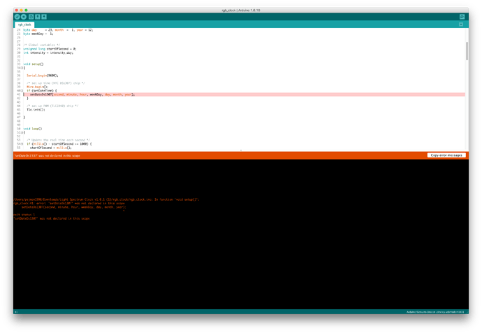

hi i'm working on this little project and despite i have all libraries i'm having trouble with compiling this fella it apears that there is only one thing wrong with it and it is this error (
error: 'setDateDs1307' was not declared in this scope
setDateDs1307(second, minute, hour, weekDay, day, month, year);
exit status 1
in attachment you can find the code and screenshot of error but when i use what ever as variable except for void before 'setDateDs1307' the error is gone but not sure which one is correct so if you could help me to handle this i will appreciate it
rgb_clock.ino (6 KB)
The IDE fails to generate a prototype for this:
void setDateDs1307(byte second, // 0-59
                   byte minute, // 0-59
                   byte hour, // 0-23
                   byte dayOfWeek, // 1-7
                   byte dayOfMonth, // 1-28/29/30/31
                   byte month, // 1-12
                   byte year) // 0-99
It will compile, if you remove the comments.
Or alternatively add your own prototype if you want to keep the comments. Just put this, (with or without comments), somewhere above setup:-
void setDateDs1307(
    byte hour,          // 0-23
    byte month,         // 1-12
    byte year);         // 0-99

still the error remains!
That worked for me, with that prototype (including comments) placed directly above 'setup()', using IDE V1.6.9. It compiled fine.
Sketch uses 8,650 bytes (26%) of program storage space. Maximum is 32,256 bytes.
Global variables use 466 bytes (22%) of dynamic memory, leaving 1,582 bytes for local variables. Maximum is 2,048 bytes.
Try the prototype without comments then, or remove the comments from the function itself as oqibidipo says.
(Then you won't need the prototype at all.)

i wish you could give me whole new code you made because i'm confused and i already gave up after 3 days of fighting against it ,sorry for being shameless!
pejman1998:
Luckily, I haven't deleted it yet. :slight_smile:
As I say, this compiles fine using IDE V1.6.9, (on windows 10 Pro 64-bit):-

The additional function prototype is directly above 'setup()'.
Let me know how you go. If there's still a problem, I'll post the other alternative.

i did use what oldsteve gave me and it did work ! so thanks but i'm still confused why this code was acting like that even the code writer used it this way without any change but we should change it like this
pejman1998:
Maybe it worked in an earlier version of the IDE as originally written.
In the Arduino IDE, a prototype for each function is usually automatically generated and placed above 'setup()' during compilation, but it appears that the comments prevent this process from happening.
