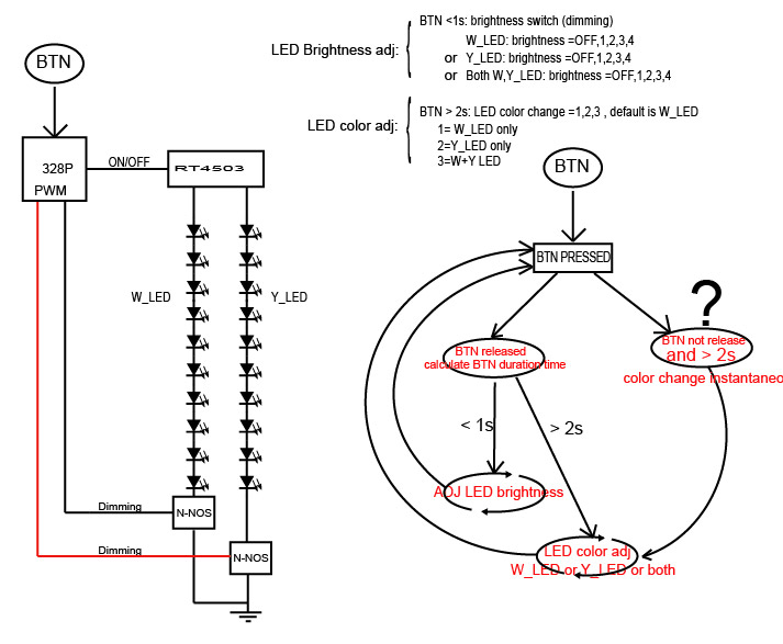

I have a sketch that need to detect button pressed time but need keep sketch running.
have any idea or provide sketch sample to help me?
for explain:
When I press button less than 1s. the sketch turn on the W_LED.
When I press button more than 2s the sketch turn on the Y_LED, but if press button more 2s and not release button, the sketch also needs turn on the Y_LED.

Sketch 3: PluseIN have 1 second waiting time when no button is pressed
duration_time = pulseIn(buttonPush/1000, LOW);
below is a part of my current sketch:
