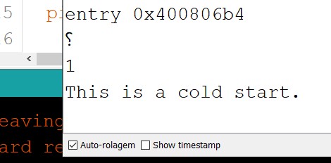

Thanks for helping with code. I tested it, my current test board is an ESP32cam. The result is always 1. Either energizing or executing the RST button:
RST
