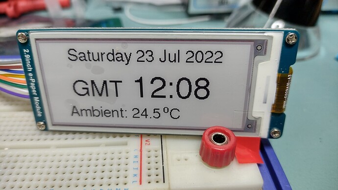

Hi all,
I would like to write correctly the symbol for degree Centigrade on my E-paper display.
I am using the GxEPD2_3C library, and using an ESP32.
There is no char code for this in the library.
So I was thinking of drawing a small circle.
Unfortunately I do not know how to do that.
Any help please?
Thank you

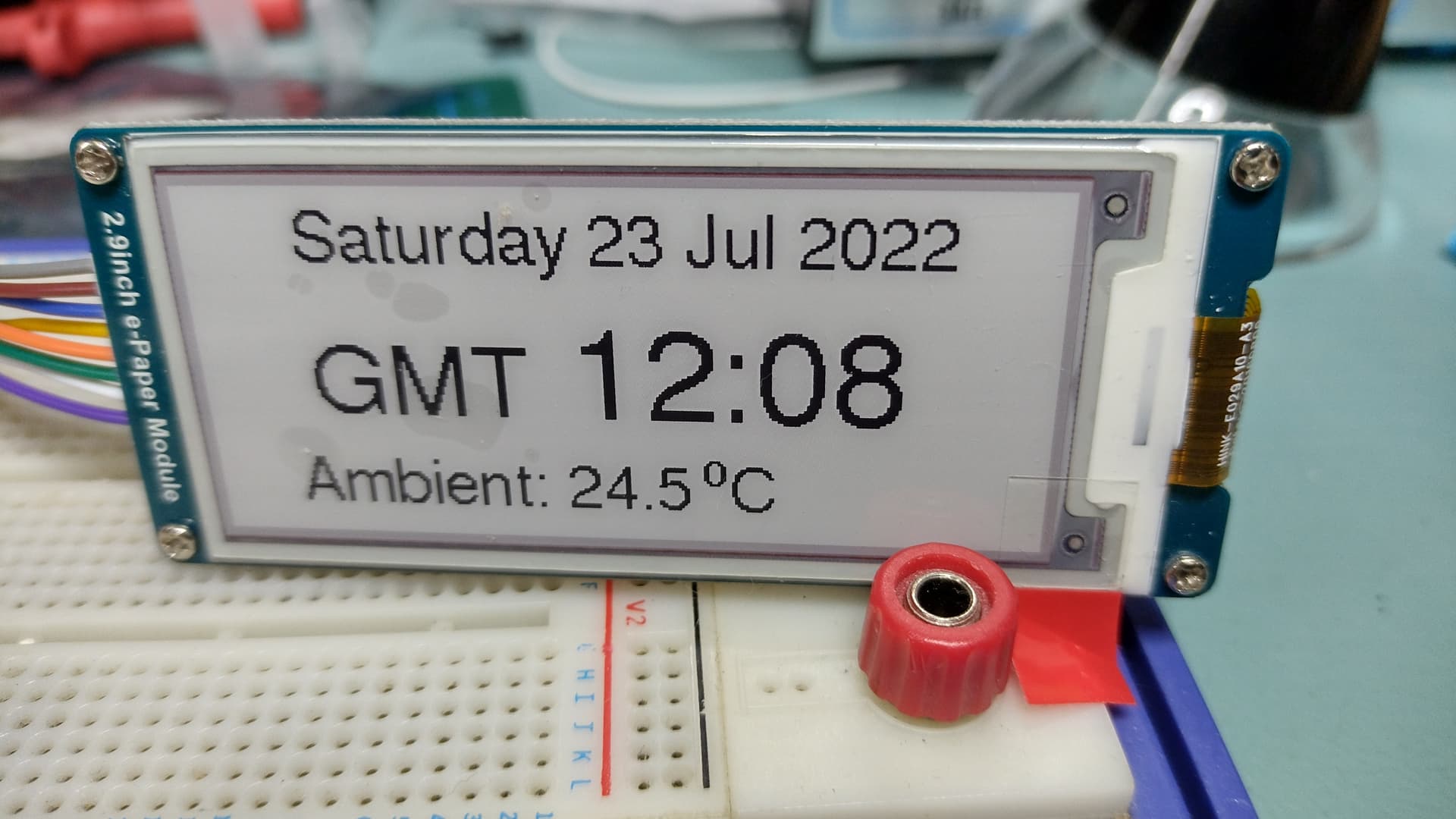

Hi all,
I had no luck in finding the my symbol ( the degree centigrade).
So i took a pragmatic approach and used the lower case 'o' and a small font.
I then set the set the screen location to raise the 'o' and the problem is solved.
