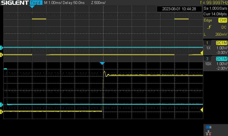

Just NOP instruction takes 62.5ns (F_CPU = 16MHz, 1s/16 000 000 = 62.5ns for 1 cycle). NOP is 1 cycle instruction. There is no time for the loop.
This:
    LED_PORT &= ~(1 << LED_BIT);
    asm volatile("NOP");
    LED_PORT |= (1 << LED_BIT);
is compiled to this:
  90:	2d 98       	cbi	0x05, 5	; 5
  92:	00 00       	nop
  94:	2d 9a       	sbi	0x05, 5	; 5
On ATmega328P the CBI, SBI instructions take 2 cycles each. NOP takes 1 cycle. Without NOP instruction it would be approximately 125ns pulse (if we suppose the pulse edge somewhere in the middle of the instruction). This is the minimum like @westfw wrote above.
This snippet of code demonstrates how you can generate pulses of 187.5ns (3 clock cycles), 125ns (2 clock cycles) and 62.5ns (1 clock cycle):
  ledOn();
  ledOff();
  PORTB = B00100000;
  PORTB = B00000000;
And the result is:
But as has been mentioned several times, you can't generate a 100ns pulse using a Uno.

The next problem is going to be that delay:
delay(8);       // 8ms
delayMicroseconds(799); // 0.799mstype or paste code here
8.799ms after the input pulse goes low is not the right place to start the pulse if we are wanting to start 200ns before the 9ms is over. (i know we can't do 200ns exactly).
There are a million nanoseconds in a millisecond, not a thousand.
The correct figure is going to be closer to 8.999ms.

Some time ago, I did some tests to measure what the delays generated by delayMicroseconds() were.
The results were as follows:
1us should not be 0.625us in result?
By a process of trial and error it seemed that :
delay(8);       // 8ms
delayMicroseconds(980); // 0.980ms
gave the best results, however there was a lot of jitter (about 4 microseconds or more).
Here is the best trace I captured, roughly correct:
but then another pulse might be too soon:
or even too late:
This doesn't seem to be a completely satisfactory solution.
Interrupts?
I've recorded it not as 0.625µs, but as 0.0625µs (i.e. 1 clock cycle).
Could it be? It was the only one that was sub one microsecond.
All the subsequent measurements were each1.2µs too short.
Maybe, does the noInterupts() need to come earlier? or does that stop delay() and delayMicroseconds() working?
yes, it does
If I put the noInterrupts() before the delay(8), then the pulse is generated just a few microseconds after the falling edge of the chopper signal.
delayMicroseconds() doesn't need interrupts, delay() does.
If it supposed to be periodic signal it have to run with interrupts disabled so no delay().
Some time ago I played with R-R2 ladder. Here is a sine signal sample:
Interrupts are disabled.
Rig up a "one-shot" (?).
Turning interrupts off and just using delayMicroseconds(), has got the jitter down to around 500ns.

I had to use delayMicroseconds(8991), plus an extra 9 NOPs to get the correct delay.
That is the value needed by my Uno and my function generator. The actual value used will need tuning.
