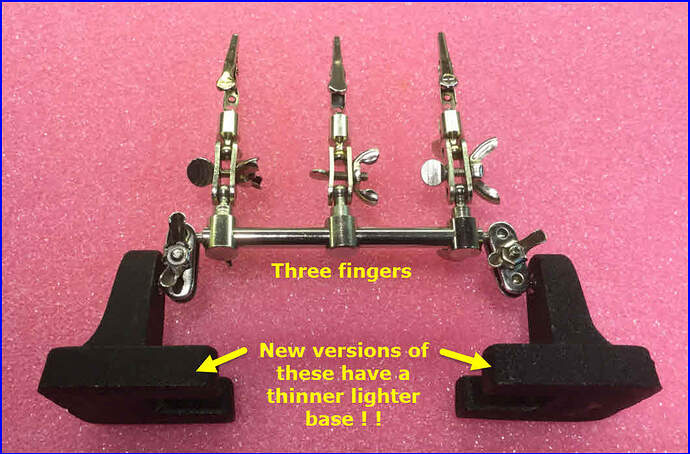

You have to get the fingers out of the picture:
