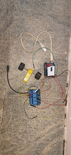

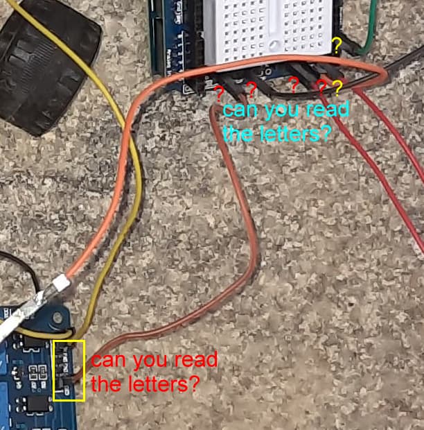

you can go on for hours, days weeks with posting short worded postings.
It is unlikely that such short worded postings will solve the problems.
And this is why I recommend that you post a picture of all your wiring.
The picture must be taken from vertical above.
After taking the picture you should do a quality-check of the picture:
a person that can only see the picture:
  • will this person be able to read the letters on the microcontroller-board?
  • will this person be able to follow each wire from one end to the other end?
  • will this person be able to identify: "this wires is plugged into PIN GND without any doubts? (and not into +5V etc.)
best regards Stefan

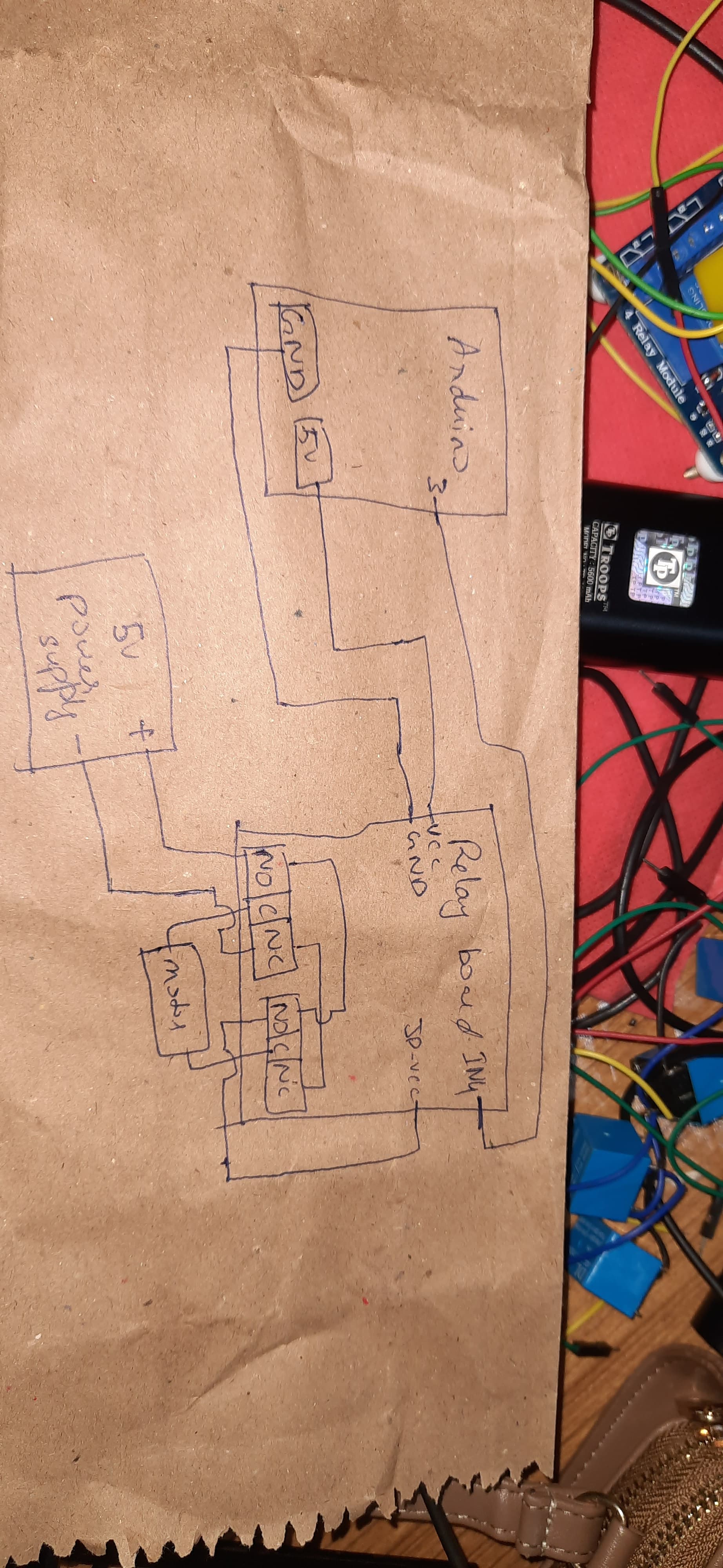

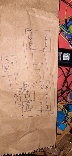

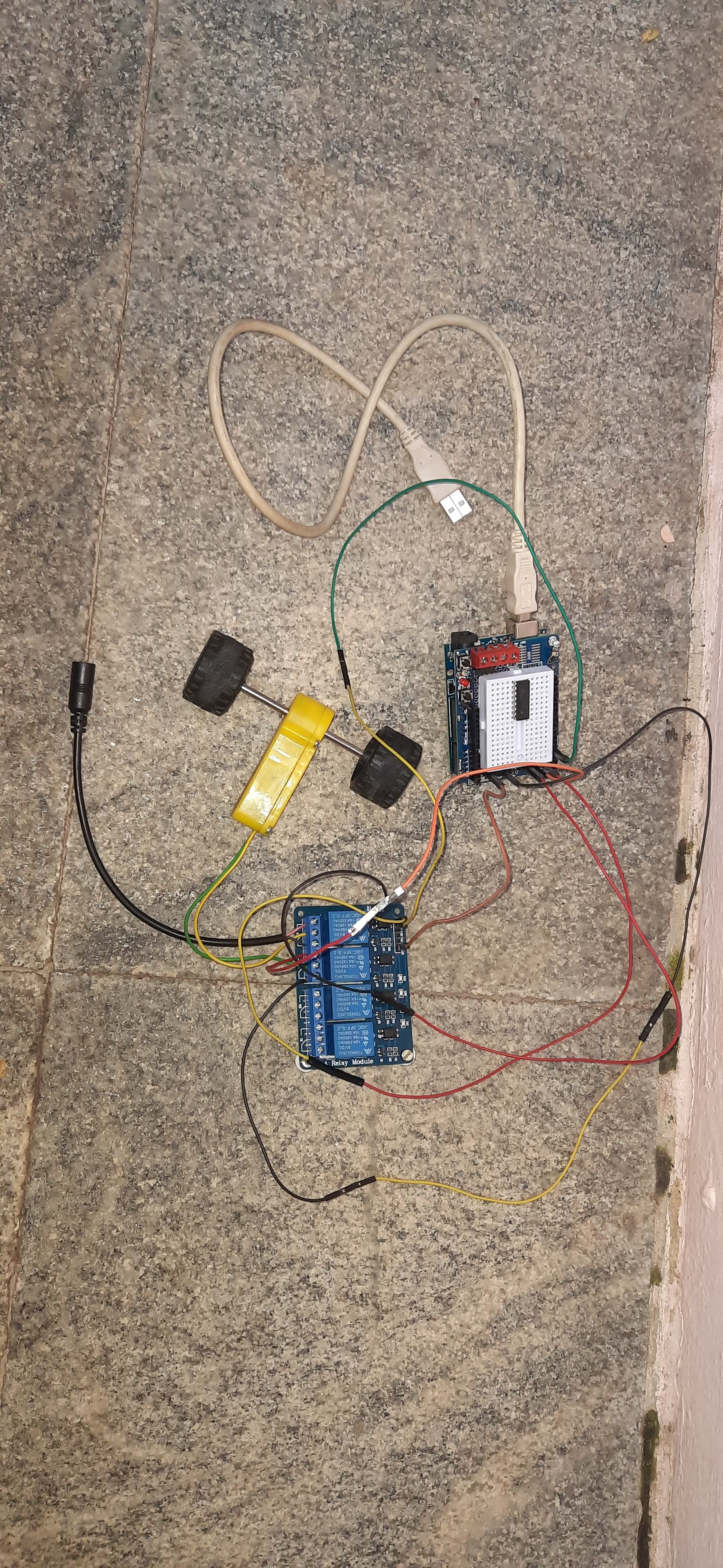

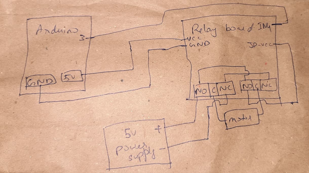

I am using breadboard shield for easier connection during prototyping only
Black DC female jack is the power supply to which I connect 5V power source. I have connected black wire to NC and red wire to NO.
I have connected motor to comm of both relays

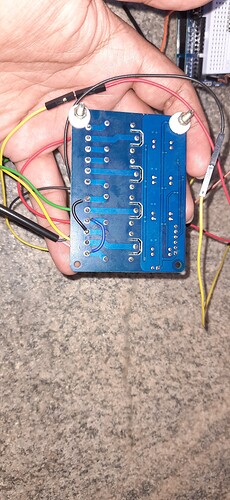

In the back side of the board, I have soldered NO to NO and NC to NC
Yes
Where is the separate 5V supply for the JD-VCC?
So that the letters are readable
You should unload the work of drawing the schematic from the shoulders of your potential helpers.
Relays don't switch immediately and that time is sufficient to cause destructive sparks and more.
The power supply - (negative) need to be connected to the relay board GND.
Done. Still no improvement
The code you show in post #1 shows you are controlling pin 5 but your diagram shows pin 3
Sorry, my bad. It is 5. I checked by connecting it to 5 again. The red light in the relay board turns off after a fraction of second and I can hear more one tick from the relay.

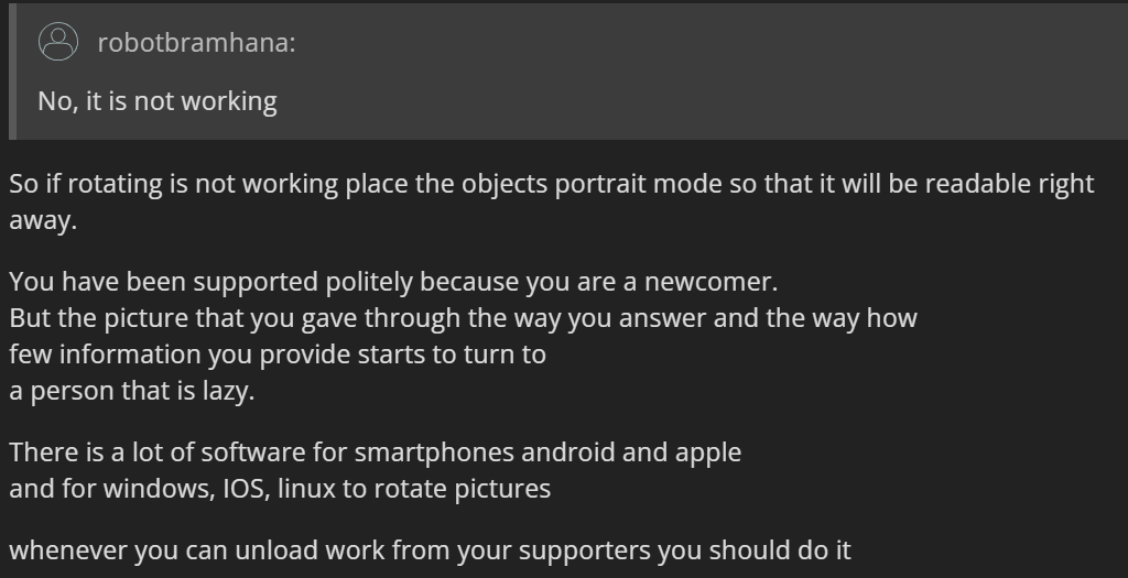

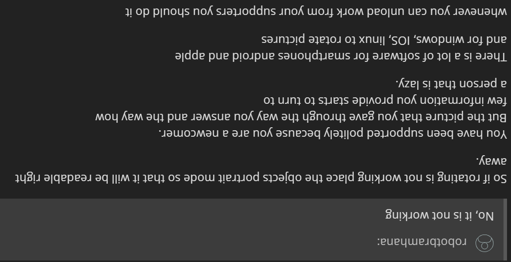

@robotbramhana post 27.
Are you very young?
It seems that very young people have no idea how to post an image in the right aspect ratio. The way you posted it will either give me a pain in the neck when viewing on a laptop, or leave you fighting with the auto position corrector on a tablet.
Please there is more to life than portrait mode, like getting it the way you need to view it.
No, it is not working
Go and experience the
additional work
to read this posting
