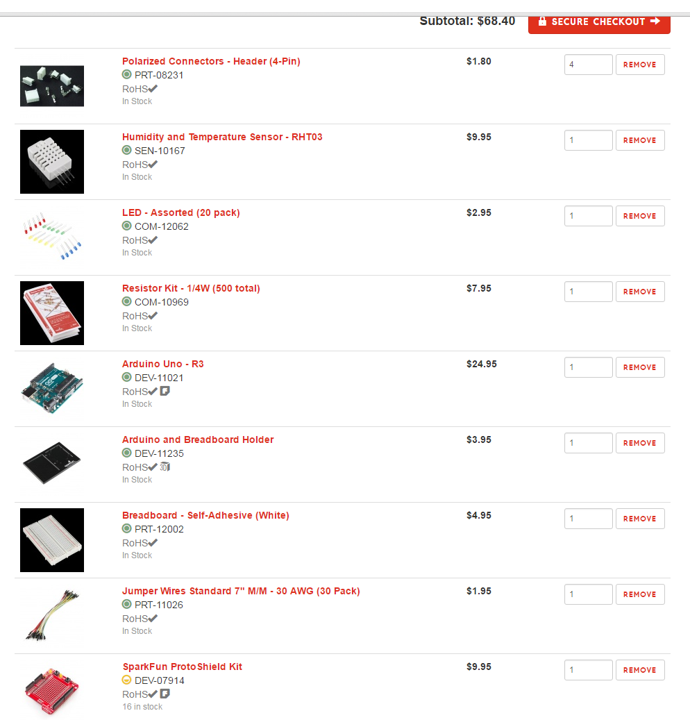

This is what I have added currently:
Anything missing? Or everything I need to get started? Is there a starter kit that would be a better deal?
Thanks again,
Kevin

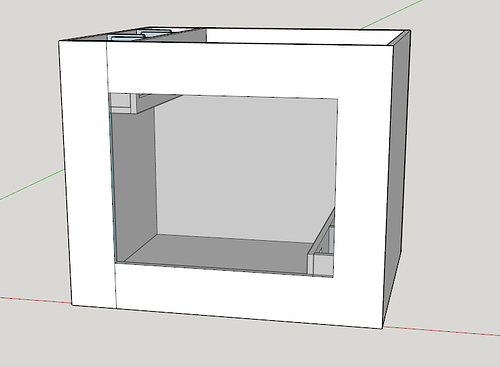

Here's the layout for the case so far:
Intake on the bottom left going thru a air duct to kill any sound then being pulled into the case with a second fan.
Out take doing the same thing but pushing air the opposite direction and pushing out in the top right.
The box will be air tight sealed with green glue and silicone so dust shouldn't be an issue unless I put dirty units in there.

Pardon me if I'm missing something here, but what's stopping you from using the PSU of the tower PC to power your fans?
Also, 120mm fans are pretty darn quiet, I think you're wasting space and costing airflow with all of those baffles.
And your baffles do absolutely zilch if you're putting fans on the outside of the case.... It's like taping earplugs to the backside of a computer speaker. Ditch the outer fans if you want to keep your silly baffles.
I'm getting the impression that you're just throwing random designs you've seen from actually engineered designs together.
I'm by no means an acoustical engineer. Just a carpenter and music producer. So basically yes they are different aspects of designs I've seen and been trying to go back and forth on some of the other forums on how to put together the venting.
I do realize those vents are a bit elaborate. I actually changed the design to only incorporate a single baffle. Just didn't have the screenshot handy on mobile.
You aren't wrong about using one of the PSUs to power the fans. I'm kind of weighing my options at this point. They actually make a molex to 12v power adapter so I could even just go straight into the wall. It wouldn't have PWM but I'm not sure I really need it.
As far as the baffles the reasoning for them at all was that if air can get in so can sound. So I've been told. So wouldn't I want to diffuse any sound waves before they entered or exited the case? I've been looking for some guidance on the vent system in general honestly just haven't found someone to bounce ideas off yet :-).

As far as the position of the fan and the baffles this is the design that I had begun to switch to. (just didn't finish the model)
[Dropbox - SketchUp_2016-08-24_14-36-01.png - Simplify your life
So a single baffle with that box roughly 6" square (still need to work that exact measurement).
