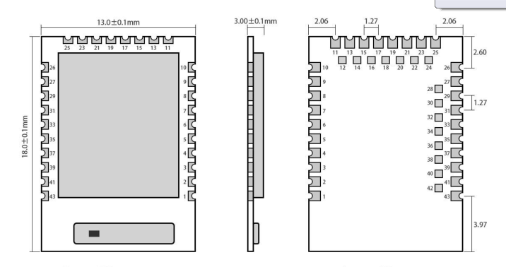

Hello,
I'm using some small modules with nRF52840 from EByte -they don't have a board preset in Arduino IDE, so I don't know which board pins are assigned to pins in Arduino IDE. How does Arduino IDE handles pin assignments? And how to identify which board pins are assigned to Arduino IDE pins? Have searched with no results.

Here is my board:

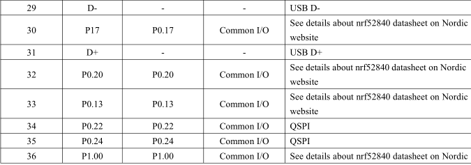

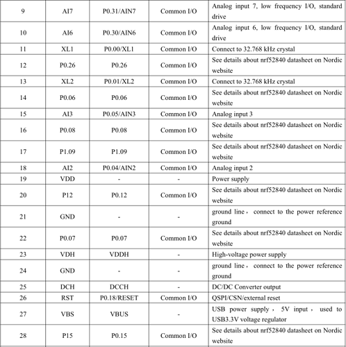

AFAICT, the nordic chips use 0-31 for bits 0-31 of port 0, using "port = pinNo - PORT0_PINS" and "bit = 1<<(pinNo % PORT0_PINS)" (not that exact code...)
The "generic" module does not appear to give you access to the pins on P1.
westfw:
So, P0.26 = Pin 26 in Arduino?
Have tried connecting to P0.26 and using Pin 26 in Arduino IDE - works. So module pin 0.N = Arduino IDE Pin N.
Still to find i2c and SPI...
