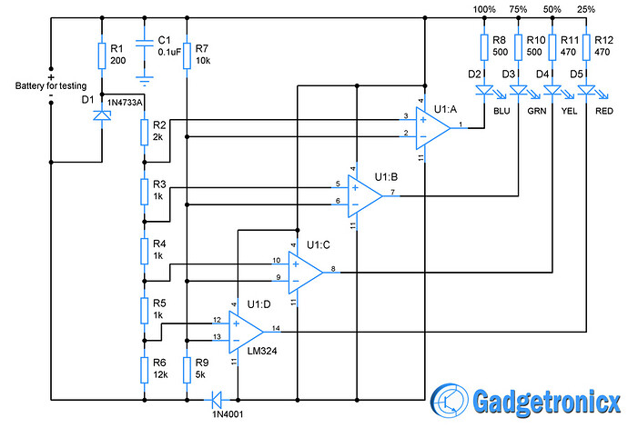

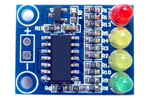

Have a look at this…. up to ten LEDs
LM3914 bar graph driver.
Really simple, link outputs for fewer LEDs,

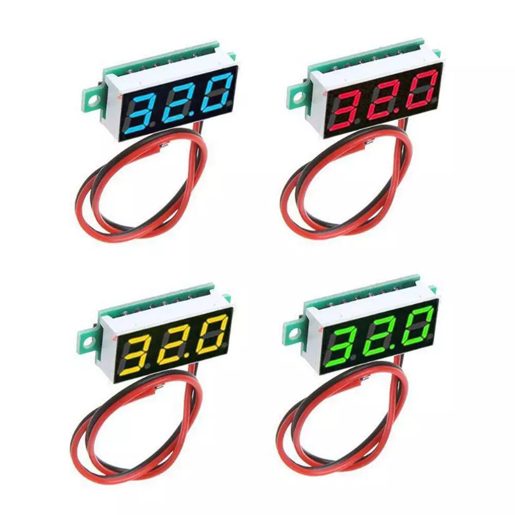

Many online places have small digital voltmeters for around $2.

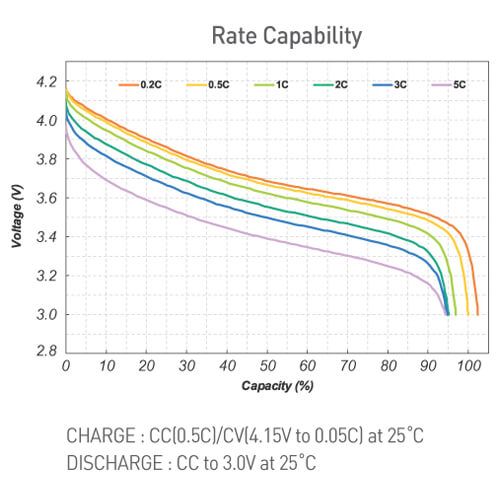

That's not my experience. Perhaps you are thinking of another chemistry.
Lipos are different. This graph I googled up matches my experience:
The SOC of a Lipo cell can be related to the terminal voltage throughout the discharge period.
I like the LM3914 idea, one would probably want to figure out how to measure with an expanded scale say 4.2 to 3.0 volts. Or to whatever lower limit you want to run your cells.
