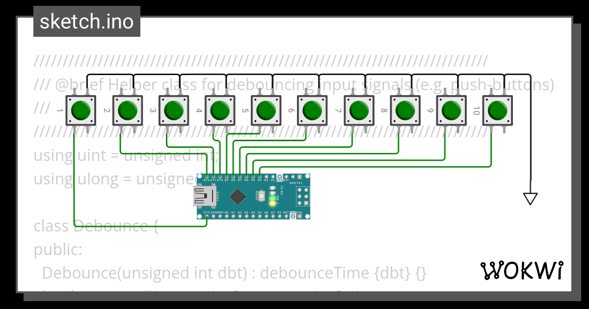

A slightly different solution:

constexpr uint8_t BUTTON_NUM {10};
constexpr uint8_t btn[BUTTON_NUM] {13, 12, 11, 10, 9, 8, 7, 6, 5, 4};
// One debounce object for each button with 15ms debounce time
Debounce debounce[BUTTON_NUM] {{15}, {15}, {15}, {15}, {15}, {15}, {15}, {15}, {15}, {15}};
void printLadder(uint8_t num) {
  for (size_t y = 0; y < num; ++y) {
    for (size_t i = 0; i <= y; ++i) { Serial.print(num); }
    Serial.println();
  Serial.println("-");
  for (auto b : btn) { pinMode(b, INPUT_PULLUP); }
  Serial.println("To start press a button...");
  static uint8_t number {0};
  static uint8_t prevNumber {0};
  for (uint8_t i = 0; i < BUTTON_NUM; ++i) {
    if (number == prevNumber && true == debounce[i](btn[i])) {
      number = i + 1;
    } else if (number != prevNumber) {
      prevNumber = number;
      printLadder(number);
#ifdef CONTINUOUS
      number = prevNumber = 0;
#endif
To try out
