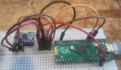

connected a BME280 and MPU6050 to a Raspberry Pi Pico RP2040

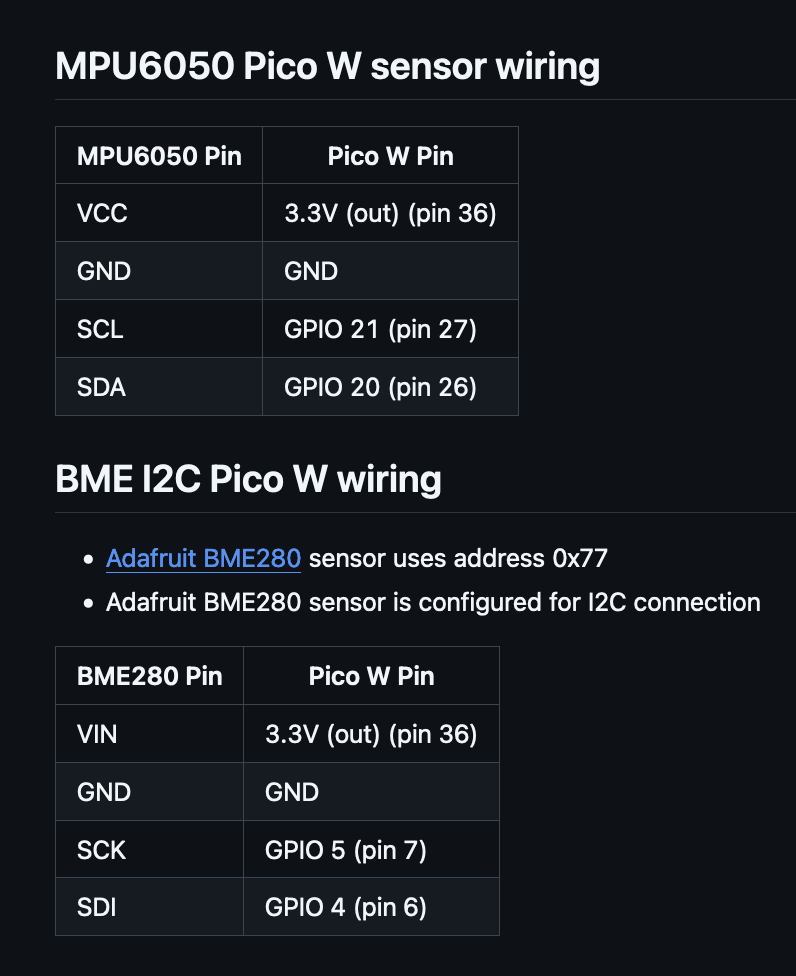

I tried your code but it is still not working. The MPU sensor cannot be located unless I add in
Wire.setSDA(20);
Wire.setSCL(21);
and then change the call to mpu.begin(0x68) with if (!mpu.begin(0x68, &Wire, 0)) which then causes the BME initialisation to fail. I think it could by the way it is wired. Would you be able to provide the wiring for your sensors and Pico? Here is mine:
I think it is also worth noting that I have the new Adafruit BME280 sensor which might have different pin outs to your BME280 sensor. I am not sure about this though!
Why are you not connecting the BME280 and MPU6050 to the same I2C bus?
both devices are connected to SCL GPIO5 SDA GPIO4
I could only find one working example for the MPU with the Pico and the solution for it was to create a custom I2C object rather than using the default wire
My BME280 has got VIN, 3Vo, GND, SCK, SDO, SDI and CS. What should I connect to GPIO5 and 4 if I dont have SDA or SCL?
using different I2C busses
BME280 connected to SCL GPIO5 SDA GPIO4
MPU6050 connected to SCL GPIO19 SDA GPIO18

document htadafruit-bme280-humidity-barometric-pressure-temperature-sensor-breakout/pinouts specifies
  • SCK - this is also the I2C clock pin, connect to your microcontrollers I2C clock line.
  • SDI - this is also the I2C data pin, connect to your microcontrollers I2C data line.
    I assume SCK is I2C SCL and SDI is I2C SDA
Thank you so much for your help. That worked for me!
