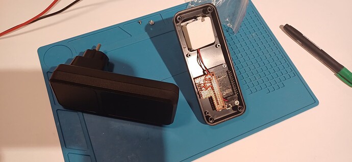

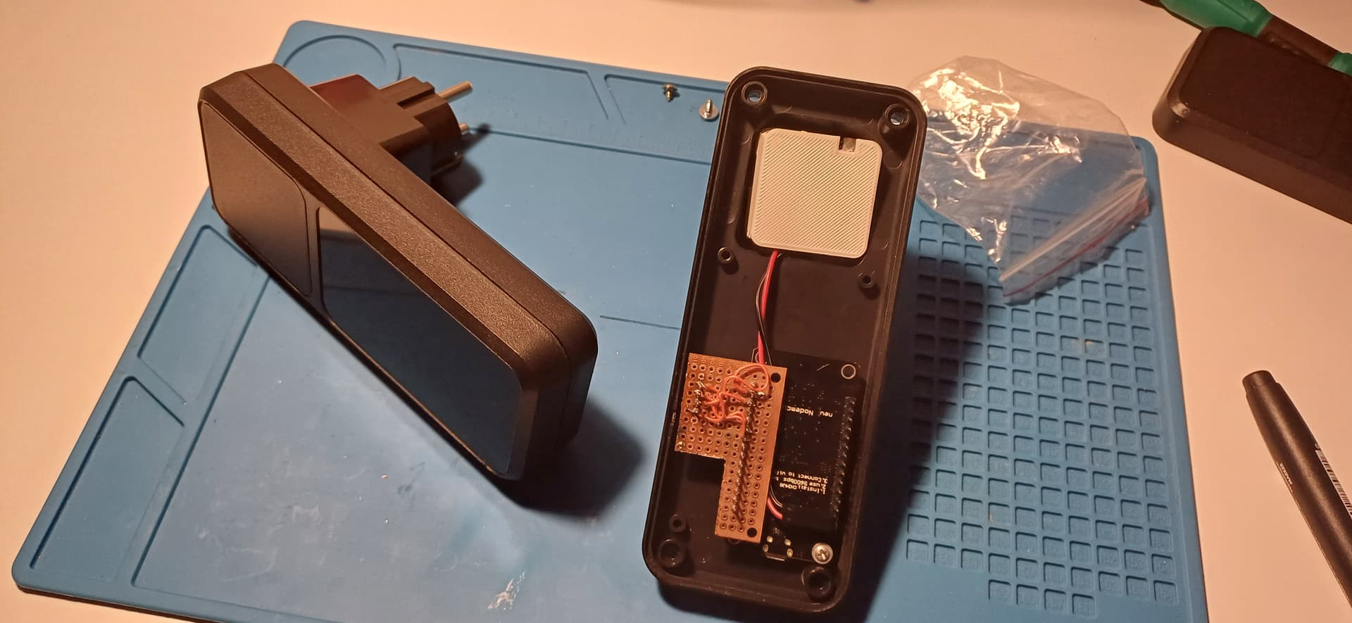

I just deployed 10 sensors all over the city to detect P-Wave
All devices send the data to a server.
When a device detect a shake it will look for other devices, if there is a match in frame time it will deploy an alarm to all my family phones.
No false alarms if someone hit a device by accident.
Now I just need away for my family to send SOS msg when they are in danger or trapped :pensive:

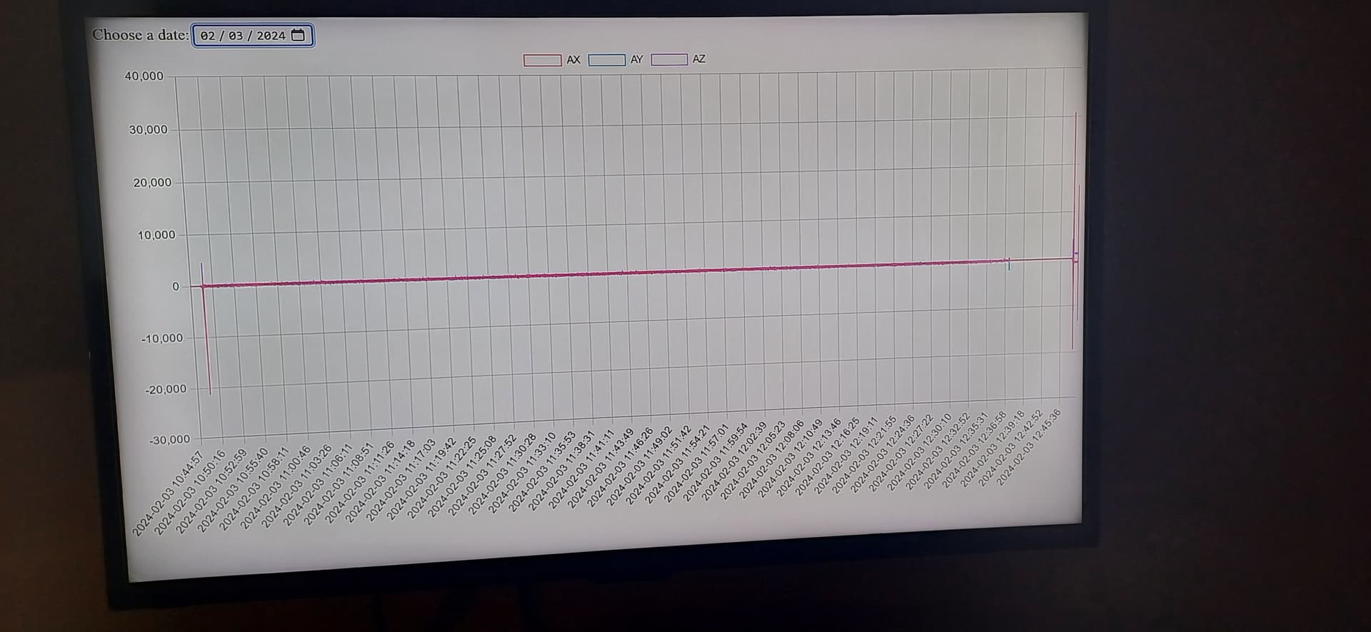

I detected P-Wave 400km away.
here you can see it 6 devices detected it
not that clear :thinking: I have to work more on the graph code to separate each device graph more
