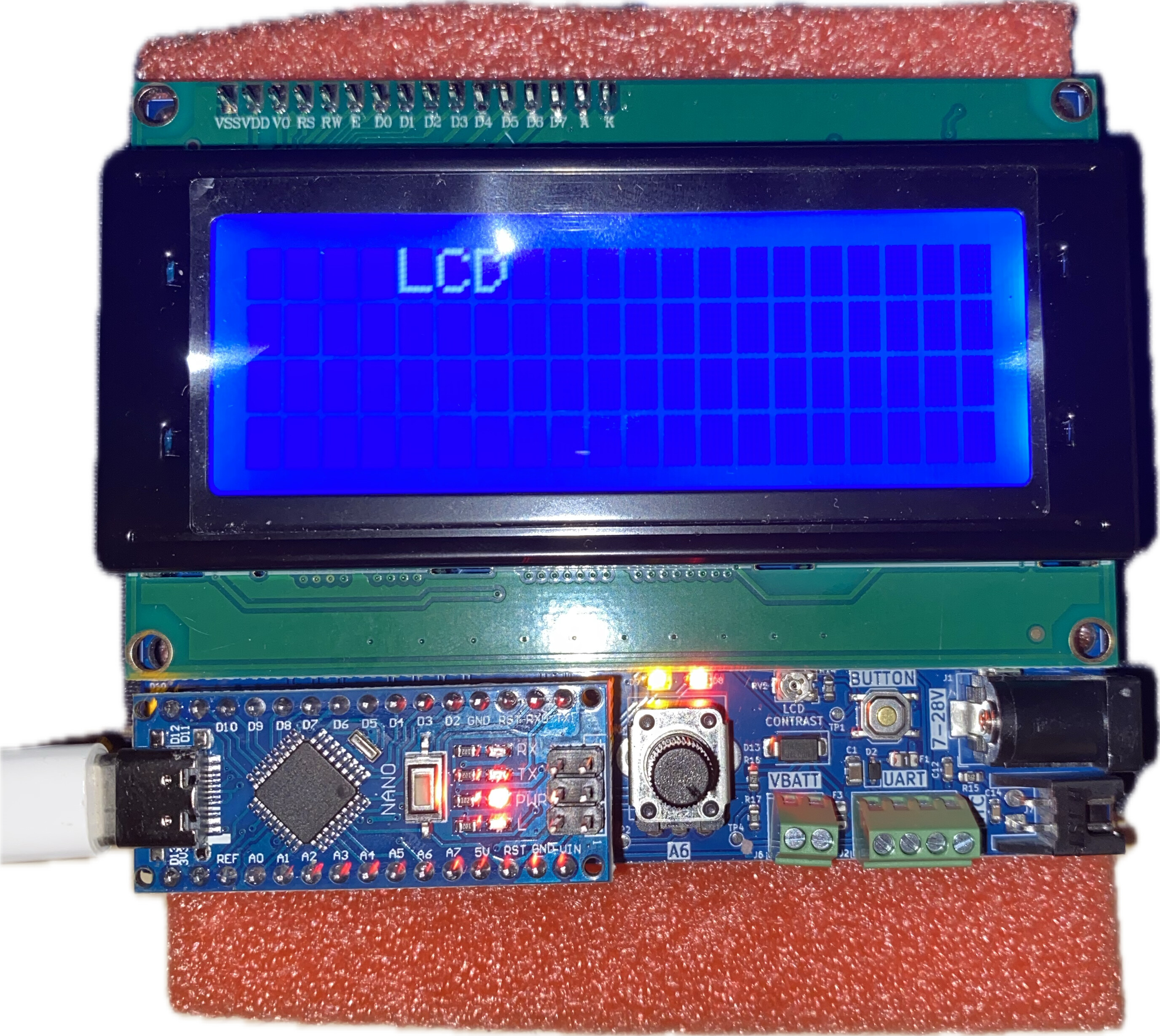

How to make my LCD update and my double blink circuit run in unison?
I'm having trouble trying to figure out how to make my LCD and my double blink program work at the same time. In my code the LCD displays the blink speed, which is controlled by the potentiometer, and holding the button makes both LEDs blink. The problem here is if I am holding the button and turning the potentiometer, this makes the LCD jutter. Does anybody know how to fix this?
Here is the code

  • The above line of code pauses all code execution for the delay interval.
  • You need to forget about using delay( ) if there is a need to do things simultaneously.
  • There is code under examples that shows how to create a TIMER without using delay( ), study this example.
  • Also, Google Arduino State Machine.
    This is one of the most important techniques, along with blink without delay, that you need to master.

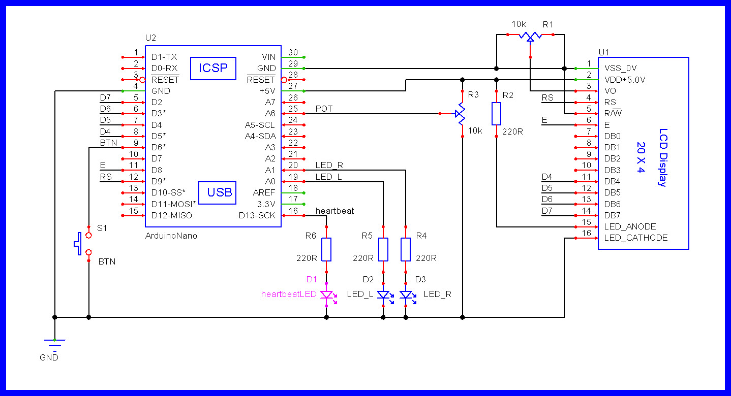

BTW
You should always start a project by making a schematic.
  • This probably does not do everything necessary, however, it should stir some thinking within.
  • Remember, if you do not ask questions on the things you do not understand, you will not learn anything.
Click for Code

Thanks @LarryD for that! This helped alot, but when pressing the button, the LEDs flash indefinitley, even once the button is released. I was also wondering what the purpose of having seperate variables for pressed and released switches and on or off LEDs, would it not be easier to use HIGH and LOW? Please enlighten me.
  • How is your switch wired, show us a good image of your wiring, it should be the same as in the schematic in post #9 above.
  • Just tested it here with the same schematic as offered you in the previous post.
  • The hearbeatLED toggles every 500ms (1/2 second).
  • When the BTN switch is pressed, the LED_L and LED_R toggle constantly.
  • When the BTN switch is released, the LED_L and LED_R stop toggling and go OFF.
  • The potentiometer setting is directly interactive and the value is sent to the LCD.
What should be different above ?

Thanks @LarryD for the explanation, I see why that makes sense now. Here is a image of my wiring. I hope this helps.
The yellow LED is LED_L and the red LED is LED_R
Also here is an image of the board with the Arduino Nano removed:
  • We are going to need to see a WEB link to that PCB.
  • The actual schematic of that board needs to be examined so the code can written to match that hardware.
Hi @LarryD, Unfortunately I could not find ANY information about the PCB anywhere online. The board was sourced through a program called Evolocity and I think it is a custom board.
