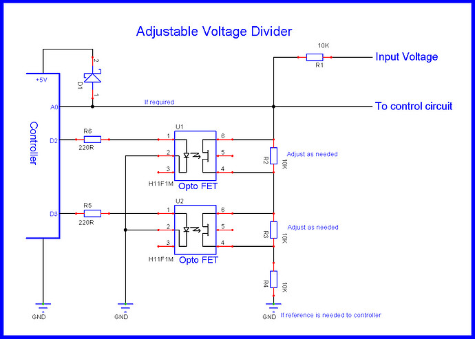

I have an EasyDriver to control my stepper motor through arduino. The stepper must carry loads between 1 to 3Kg. I can use a 12V 2A power supply or a 14.4V 2500mAHr battery if I'm out of home.
My purpose is, when stepper must carry light loads, to have an LCD menu where I can set up to supply less voltage to the driver to prolong battery life. As I read, lower voltage produces lower torque in my stepper motor driver.

You can use some fixed resistors in the divider which are shorted out with an opto fet.
larryd:
Can you give me more details about please?
In short, its a way to replace the potentiometer with a series of distinct values.
Determine which voltages you need.
Build a stack of resistor with multiple resistor segments that will produce the voltage you want (total value of resistors should be 10K to mimic the one you are replacing).
Use a opto fet or relay to connect the selected discrete voltage value to the REF pin.

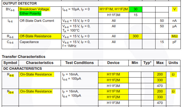

https://www.fairchildsemi.com/datasheets/H1/H11F3M.pdf
H11F2M or H11F1M are rated at +-30V

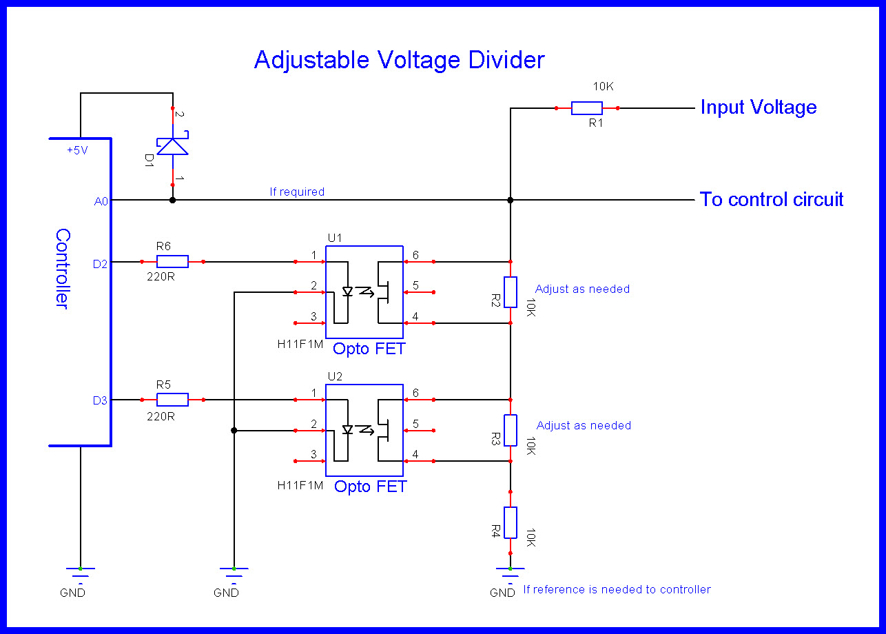

EDIT
Updated schematic
Might want to use H11F2M or H11F1M which are rated at +-30V
Ok. I try it. It seems a good solution.
