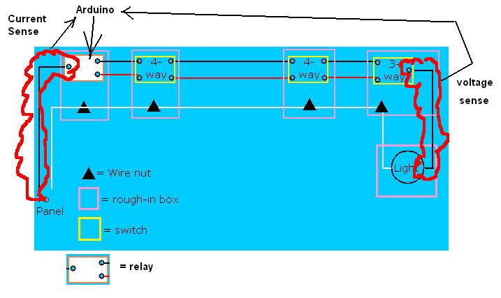

If you use one relay that is controlled by teh Arduino, you ahve one 3-way switch. then, you have all 4-way switches in the rest of the house, and of course, one other 3 way on the other end to complete the loop.
now, all you need to do is to know if there is current on the line.
there are a few ways, some invasive, some non-invasive.
a CT or current transformer
http://www.ebay.com/itm/141689383548
could be put on one end of the line and monitor, by aid of the Arduino. if power is being used.

what I was getting at was that if you put a bank or relays in the home automation panel, you have a starting point that is both accessible and conveniently located.
in order to measure if the light is lit, you have many choices. a light sensor. a heat sensor, a voltage sensor and a current sensor.
light and heat are only present at the lamp itself.
voltage is present at all times on some wires, which wires depends on the state of the switches, and only the wire to the lamp will have voltage when the lamp has power. ergo, the only valid place to measure voltage is at the lamp.
since you have a central panel, you have a single common power wire. if the lamp is lit, there is current. if the lamp is not lit, there is no current. there is always voltage.
it is my belief that a choice between running a wire from each lamp back to a panel is more difficult that testing for power at the main panel. I also believe that since the OP does not trust in automation, that having the central location makes troubleshooting easier.

the choice of a local current transformer vs running a wire across the house back to the panel
or locating the Arduino in the wall next to a light switch in the room that the light is in.
I would try to make the case that having an Arduino in every room, one for each light would be difficult, but in all honesty, I like modular and single device controls.

a bit more about choices :
local voltage sensor has to have a circuit tied into the mains voltage. that means either there is a direct line, albeit with resistors, or an opto.
if the control is remote, then that wire has to run to the control.. choices, choices.
if you add a board with an opto, and resistors and such. you add complexity.
The goal of not using the Arduino as the master forces some of these choices.
