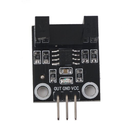

That's only the photo interrupter. A photo interrupter has an LED on one of the "forks" and a phototransistor on the other. If something opaque is inserted into the slot, it blocks the light from the LED from hitting the phototransistor. You also need an encoder wheel to go with it. The encoder wheel is a disk with slots cut into it, which will alternately permit and block the LED light as the disk rotates, generating pulses from the phototransistor. The resolution is determined by how many slots the encoder wheel has.
So would this be well suited for my use case, provided I can make a high-resolution disk??
I'd think so. There might be specific applications where this is not well suited, or another solution is better. You can get pre-made disks for these photointerruptors that fit onto a standard consumer DC motor:
Having everything out in the open could be an issue in a dirty environment. If the LED or phototransistor get covered with dust and grime, they're not going to work. It could be a good deal of work to make an enclosure.
You can get one-piece rotary encoder modules that are all enclosed.
You can get encoder motors that have everything in one package, though a lot of them are Hall effect.
