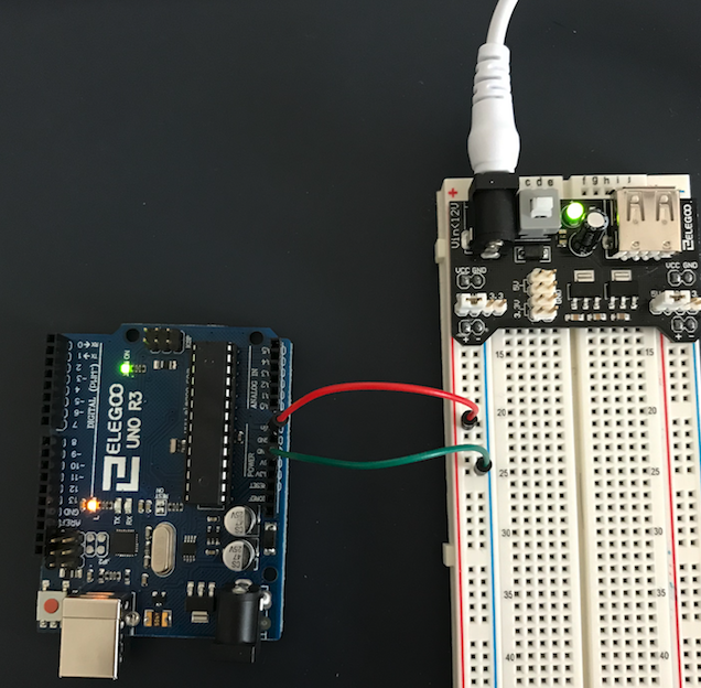

Unfortunately i don’t have USB power meter. I plugged a power supply module (1PC) to a breadboard. Now I used one cable coming from the (+) point of the breadboard into the vin pin from my Arduino. The (-) point is connected to GND pin. (see picture). I also tried to measure the current put the meter in-line.

Your setup in the picture looks OK. I assume that your Arduino is working perfectly this way?
What do you mean by "no result"?
You should set your meter to "200 mA" and connect your leads to COM and VmAOhms. Does your meter read 0 A? Try lowering the dial to "20 mA". What happens?
If your meter doesn't respond to any current measurement it could be because a fuse is blown. if so, check the fuse. You may also want to check the battery while you have the case open.
Yes you are right it must be the fuse of the VmAOhms lead(I guess). Now I put the lead into the 10A and it shows 00.3 when the dial is at 200mA (see picture). Before it didn’t even react to anything and the arduino couldn’t even start.

If the Arduino can't start when you're using the middle socket then it is surely a blown fuse that is to blame.
From the reading you're showing the current is 0.3 mA, which isn't much. Try to change the setting to 20 mA or even lower to see if that gives any useful reading.
The manual says that you must use the middle socket on the meter for measuring less than 200 mA so you'll probably not get any accuracy from using the 10 A socket. You need a new fuse.
Also I fear that your meter is not accurate enough to measure any change in power consumption, but you'll just have to test it.
Also if you need to find how much power the board is using you need to measure the voltage while you are measuring the current. Note that when you use a significant amount of power the voltage will often drop.
