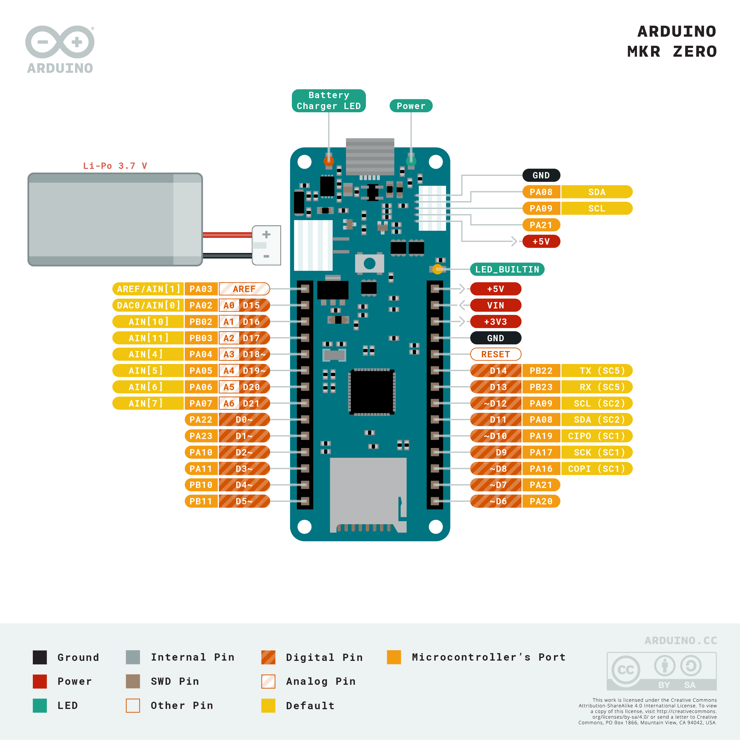

I want to build another parallel input device using PDM microphones, but I cannot. Can anyone help me?
Environment
-Board: Arduino MKR Zero
-Sensor: Adafruits PDM MEMS Microphone 3492 x 2 (Mypdm and Mypdm02)
Connection
Arduino : 2 (PA10) to pdm : CLK, pdm02 : CLK
Arduino : A6 (PA07) to Mypdm : DATA
Arduino : 11 (PA08) to Mypdm02 : DATA
Coding
Using the "PDMZero" library, I created two instances of "Mypdm" and "Mypdm02" with the following code.
I modified two instances by referring to the example sketch PDMZero_Raw.ino.
(https://create.arduino.cc/projecthub/voske65/arduino-zero-pdm-microphone-9136cb).
Result
The result of this code is not available.
The error message is "Failed to initialize I2S/PDM02!"
Question
Is it possible to create multiple instances using the "PDMZero" library?
Or is it a problem to use the same CLK argument (2) for two instances?
