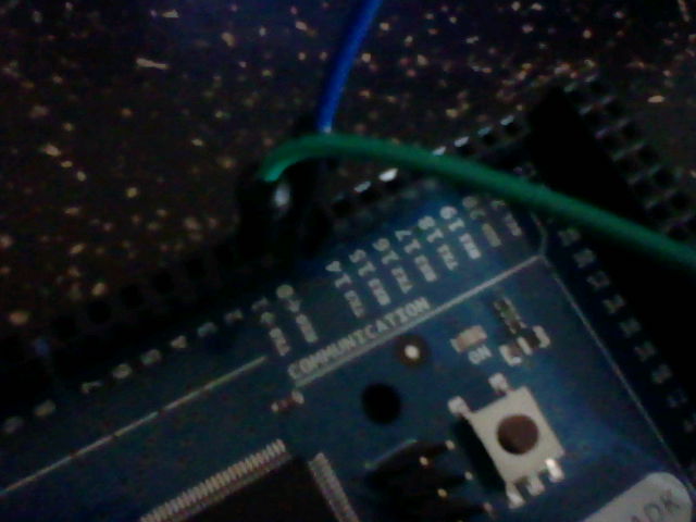

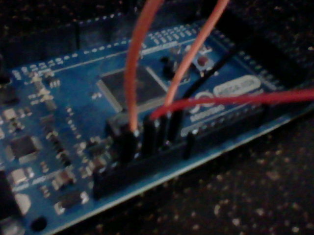

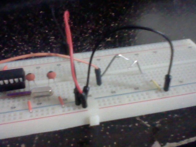

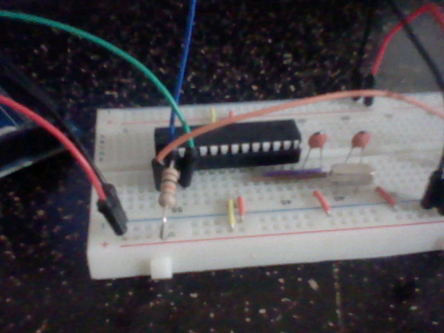

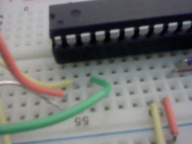

I've included pictures of my setup (sorry for bad photo quality)
The ground wire for one of your two capacitors next to the crystal seems to be in the wrong place
Furthermore, if you want to use a MEGA board as the USB-Serial adapter, you need to put a wire from the RESET pin of the Mega to GND so that the chip doesn't start interfering with the TX/RX lines.
Also remember that the TX on the MEGA board needs to go to the TX on the ATMega328 (and RX to RX) - there is no crossover needed as that is done on the PCB of the MEGA board.
You were right about the capacitor. However, The RX and TX lines see fine to me. I put different color wires so It's easier to see the difference. And as for reset, don't I need to connect it to the reset on the 328? That's how it is according to http://arduino.cc/en/Tutorial/ArduinoToBreadboard, with it connected to 5V with a 10K resistor. With the Mega do I just not do that?
I don't see anything in your picture that will keep the MEGA CPU from interfering with the serial communications to your 328.
The usual recommendation when using an Uno is to remove the chip.
The "siganature = 0" is what I get if I set an upload talking to ArduinoISP with no chip connected to the SPI connector, so I suspect that you're still running ArduinoISP on your MEGA, and the upload is talking to the MEGA instead of to the 328. Or something like that.

The new error after changing the capacitor problem is :avrdude: stk500_getsync(): not in sync: resp=0x00
