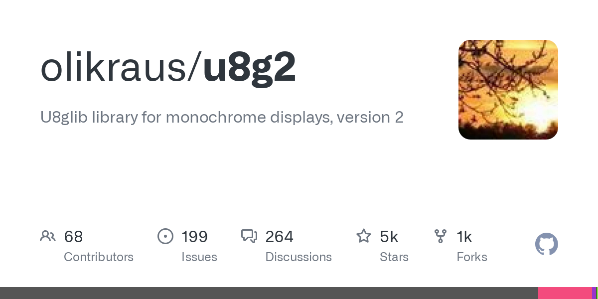

With monochrome OLED, you can use u8log:

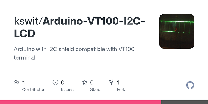

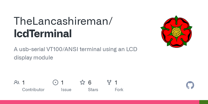

As for your contention that there isn't any code out there that someone's spent more my 10 minutes on, here's what I turned up in a 2 minute search:
