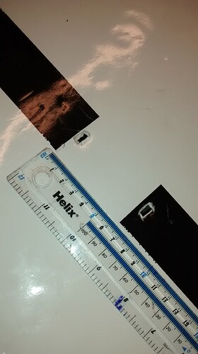

This is the track. Its quite large as it can be seen on the image. About 2x2m
The line is 4cm thick.
The photos show the dimensions of the white space. Upon reaching this it should stop.

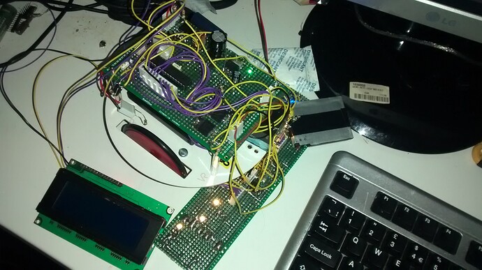

These photos show my own design. It is composed of an Atmega 328 Running arduino. Supply voltage is 6V from 4xAA and I use a boost regulator to have a regulated 9V supply to power the sensors and the microcontroller. Motors are powered from the 4xAA unregulated 6V supply using PWM trough a mosfet each, with a relay currently being used to brake them.
I need to avoid using the brake as much as possible as the gearboxes on this are very week and often rip the gears apart. We are free to chose our own design but not the base and motors/gears.

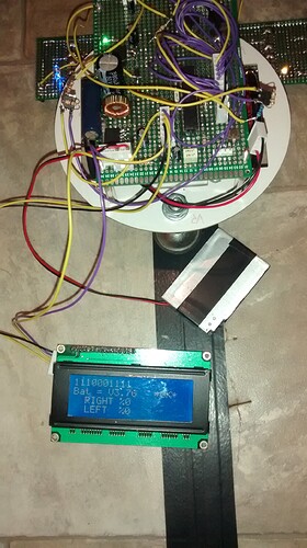

This photo shows my sensor configuration with the 10 sensors. The 2 sensors on the middle are S4 and S5 and are positioned such that they should always stay under the black like
Here are some more Photos. i am having trouble with the attachments, hence Ill post only two at once.
here is the last photo, showing the thing powered. My line, however is a bith thicker than the 4cm and hence 3 sensors are under it. The combination is invalid. I get this a lot when I define the combinations and its quite a problem. Any advice?
Anyway the main issue is that the microcontroller seems to take way too long to compensate when one sensor gets out of the line. perhaps its inertia or something so it goes three or more sensors out before it actually compensates, which makes the loop become very unstable until it reaches the end sensor, where the brakes are applied. I want to avoid applying the brakes as these gears are very fragil and I already damaged 2 sets of them.
